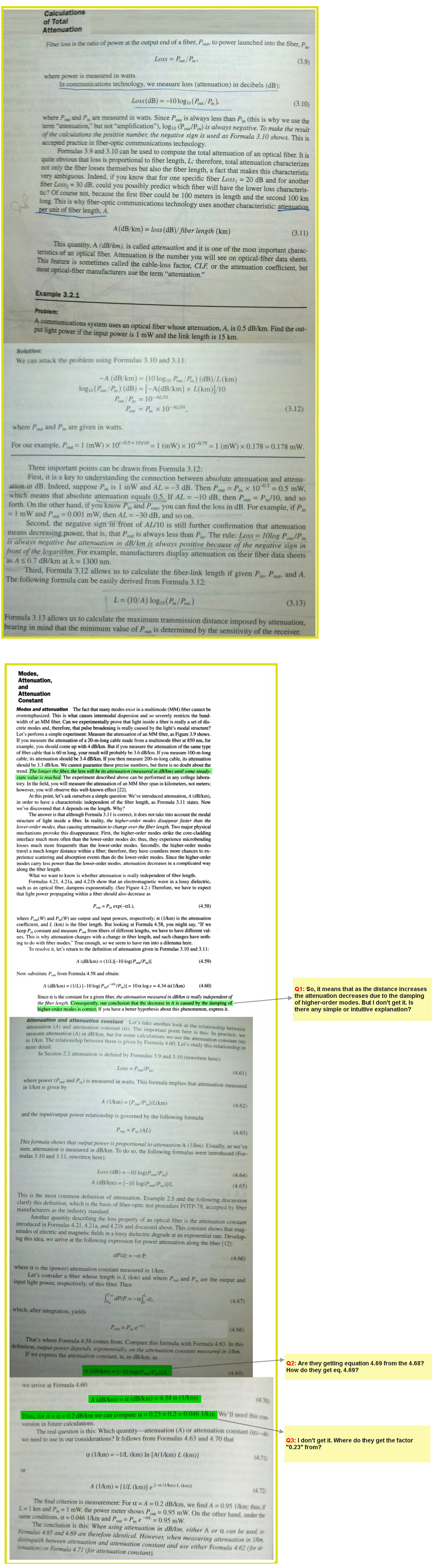

Hi
Could you please help me with these queries related to optical fibers? Thank you.

Q1; I dont really know exactly what is the answer, BUT I do know who will be able to tell us. My guess is that there is a power loss associated with the light reflection at the interface between the core and the cladding. With higher order modes there are more reflections, so these higher order modes get attenuated more.
Q2 and 3; The attenuation is given as a logarithm to either the base 10 OR to the base e.
A decibel is the power ratio using the base 10. A 'NEPER' is the power ratio using the base e.
EQ 4.69/4.70, they are calculating in neper and the conversion of neper to dB is the ratio 4.34: ie 10 log e = 4.34.
The factor 0.23 is 1/4.34
Again, I hope, but I am sure, our 'teacher' will check all this for us.
PG,
rumpfy's answers are good. Certainly Q2 and Q3 are correct and seem complete to me. Q1 is actually a question that could be answered in very great detail. You can keep things simple by considered a "ray" model for the fiber modes, and in that case, talking about reflections at the core cladding interface is a good way to picture it.
For Q1, you can also go in great depth about field based modes which are discrete field modes with independent propagation constants. These modes are orthogonal and do not cross couple in an ideal world. But due to fiber imperfections, stresses and bending, the modes can couple. Each mode will be described by it's own independent loss per unit length which can be viewed as a constant number to keep things simple. That loss is made of material loss (absorption and Rayleigh scattering) and bending losses (micro bending and macro bending), as well as imperfections of various types. Each mode can have different values for each of the components of the loss and hence the total loss can and typically is different for each mode. So, the very complex loss behavior of the total power in a multimode fiber can be simplified conceptually if one realizes that the total power is distributed across a finite number of guided modes each with it's own loss. The model can be made a little more complicated by considering mode coupling where the power in one mode can also cross couples over to the other modes.
Basically, the real answer to Q1 is very complex, and requires an electromagnetic field approach to the fiber modes and a detailed understanding of the various effects in fibers including, micro bending loss, macrobending loss, scattering, absorption, mode coupling, guided modes, radiation modes etc. The ray picture of light propagation can simplify the understanding of this to some extent but can also make the behavior seem mysterious, and is not altogether comprehensive enough to include all observed effects.
Thank you, rumpfy, Steve.
Q1: I find it quite weird that attenuation decreases as the length of the fiber increases because intuitively it should have been that attenuation increases as the length increases.

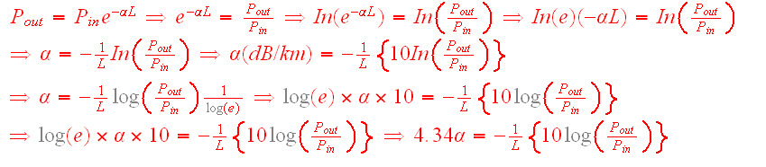

Q2: I'm still confused. Are you saying that the "log" in eq. 4.69 is a natural log. Please have a look here.

Q1
Why should attenuation increase with length?
The modes with higher loss will lose their power faster and eventually won't have much power further down the line. This means that the only modes with power are the ones that had lower attenuation. It's kind of like "survival of the fittest". Only the modes with lowest lost can propagate the long distance, so further down the line the attenuation is lower because the surviving modes have the lowest attenuation.
Q2
Eqn. 4.69 uses base 10 log. But, 4.68 is using natural log/exponent. For natural logs we have units of Nepers per unit length and for base 10 logs we use dB per unit length, with that factor of 10 needed for the Decibel. The factor of 4.34 (0.23) allows conversion between the two units.
Note that eqn. 4.69 is nothing mysterious. It is just the definition of dB and then you divide by the total length to get attenuation as loss per unit length.

Q1: I think I was picturing it wrongly. Attenuation, A, is defined to be dB/km. It means that if loss during first kilometer length is 2x and then during second kilometer length is x, then combined loss for 2km is 3x, and average loss is 3x/2=1.5x/km. I hope I have the basic idea correct.
Q2: Eq. 3.11 for attenuation, A, was derived systematically. But is this really correct that eq. 4.69 is just the definition of attenuation constant? I don't see it being derived from anything.
I understand eq. 4.70 now.
Isn't 3.11 and 4.69 the same equation? Why are you ok with 3.11 and not with 4.69? This is just the definition of decibels. I'm sure you've seen it before? Yes? No?
Hi
I do understand the definition of decibels. The definition of decibel is dB=10log(X2/X1). Eq. 3.11 is derived systematically but on the other hand eq. 4.69 is just thrown into without any derivation. They are the same equations but in one equation we have "A" and in the other there is attenuation constant, alpha. I think I'm just confused and will get around it soon. Thanks.

OK, it may be that one reference treats it better, but in fairness to the second reference, the basic formula is shown in several places (eqns. 4.59 and 4.65).
Keep in mind that it is often best to use several different sources to get the best understanding of a new or difficult topic. This is true of text books and even more true of journal and conference papers in the literature.
Thank you, Steve.
Both references are from a same book, Fiber-Optic Communications Technology by Mynbaev, Scheiner . The top excerpt was taken from chapter #3 and the bottom one was from chapter #4. The material from chapter #4 had reference to a section from chapter #3 so I included both.
In eq. 4.62, attenuation, A, has unit of 1/km. The attenuation coefficient alpha also has unit of 1/km. Therefore, I think, we can say that "A" in eq. 4.62 is just the definition of "alpha", or A=alpha. Thanks.

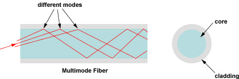

Hi
Does it mean that when a single ray enters into a multimode fiber, it spreads into multiple rays where each new ray follows a different path? Could you please let me know? Thanks.
