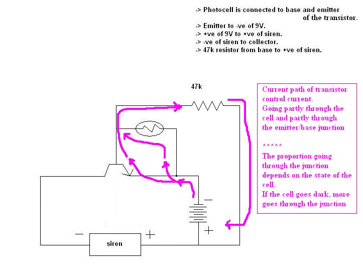

And also, do you know approximately how much voltage the laser (or any light source) has to provide to the photocell to turn the transistor on?
Well, its light really, i would say ordinary sunshine should push that sensor
to maximum conductivity.
Fortunately those little lasers have a pretty narrow beam, so the light
intensity is pretty high in the 'spot'.
At the other end however, most sensors dont start to respond until its
far from being dark, usually it needs to be better than even gloomy,
before a change is noticed.
Unless they are more sensitive than they used to be.
And the resistor just simply controls the current.
Well sort of.
In this case it sets the range of current that the transistor will operate within,
the cell controls the output current depending on the light.
The resistor is chosen, so that the base current is not too much for the cell to control,
and also that it has to be enough to turn on the transistor when the cell is dark.
Hope that makes sense ... the cell has direct control, the resistor sets the range.

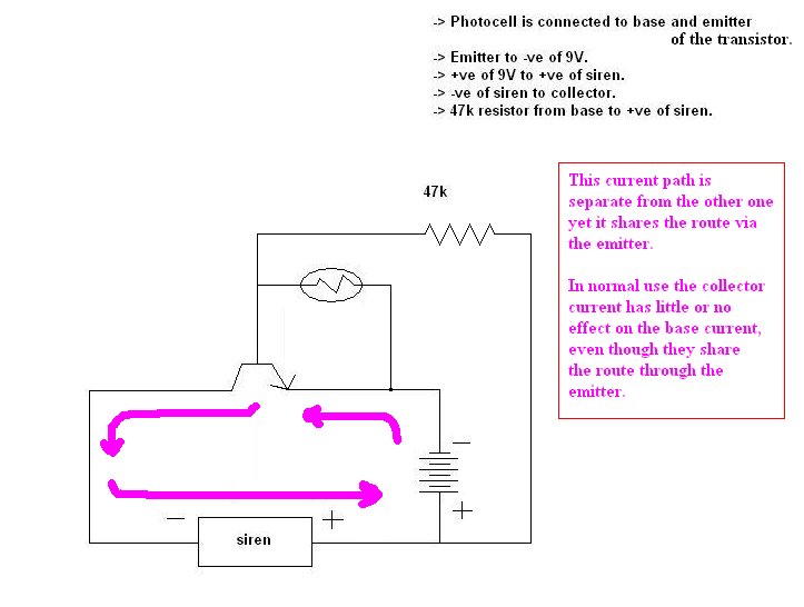

The concept of the emitter being in both the controling current path,
and also the output current path,
seems to need further clarification.
I will attempt to show how this occurs on the diagram.
back soon.

Okay ...
heres the first part of the explanation concerning the operation of the
cell, and how the resistor sets the current range,
and the cell can alter the current in the emitter/base junction.

Hey John, one last thing:
Briefly:
The transistor in this case is used as a current amplifying device,
the output current being controlled by the smaller base current.
The emitter is common to both current paths.
So the transistor is not used as a switching device anytime? I thought that this (a switch) was what we were using the transistor as.
And if you already answered it, whoops, and sorry.
my latest offering, and i wish i could set this out without arrows.
but never mind.
So long as you get the gist of it, i'm sure it will be fine.
Unless your tutor has a background in electronics,
it is unlikely he will have any particular opinion about current direction anyway.
So long as what you say makes sense, i'm hoping theres no reason for
direction to come up at all.
Just drawn this for you ,see what you think.
John :)
Ah ok. Sorry! Hopefully this is the last question: so the first diagram you had--is that current circulating when the light is on the photocell? Then the second diagram's current illustrating when the light is off the photocell?
