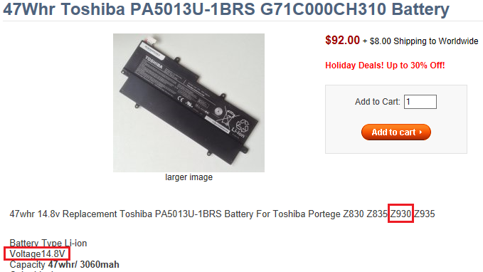

Impossible. Lithium-Ion cells are about 3.7V each then the battery is 8 x 3.7V= 29.6V, not 10.8V.
I found an ad for the 14.8V battery. Then it must have 14.8V/3.7V= 4 cells, not 8 cells.
I have opened the battery and there are 8 flat cells. The information is copied from the service manual for the unit.
