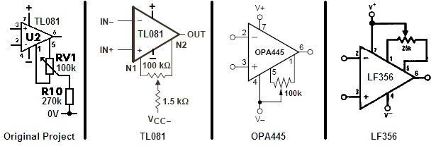

My best "cool" replies in the power supply thread were deleted by the moderator when I explained that it is bad practise to operate an opamp with a supply voltage higher than its absolute max allowed voltage. He thinks it is OK to have the supply voltage too high if the temperature is not also too high. He also thinks that if the transformer can supply more current than is needed then the circuit will draw too much current.
Leave the wiring of Q1 like in the original schematic which is correct, it doesn't make much difference.
Change the wiring and resistor for the offset voltage adjustment so it is correct for the opamp you use for U2.

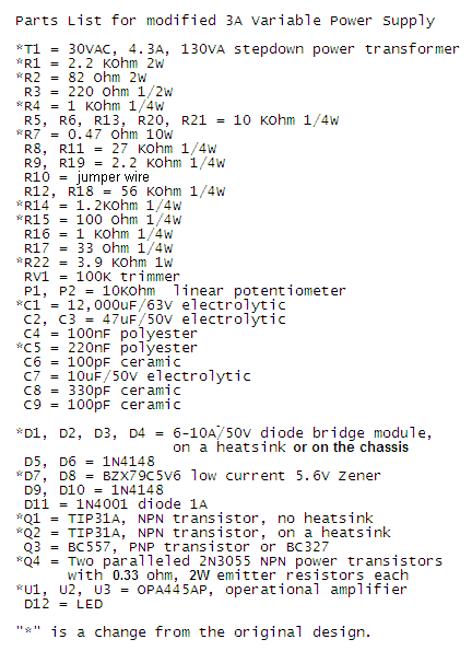

Here is my latest corrected parts list without a BD139 for Q2 which nobody tried yet:

Oh @ audioguru.... You suggested the BD139 for which transistor? I got a couple anyway so I can try them if I ever get this project completed.
R15 was changed to allow more voltage on the output of the PSU only if you fit the TIP31A??? is this correct? And If I fit the BD139 do I still need to change this resitor nto 100R???
The BD139 is a very fast transistor and improves the circuit's transient response when it is used for Q2. It will need a good heatsink because its max allowed power dissipation is low.
No. R15 wastes about 2V (3 or 4V if the output transistor is a single 2N3055 with low gain) when the output current is 3A and the transistors have minimum gain. With 100 ohms then the loss is only 0.2V.
Yes, to avoid too much voltage loss at high output current.
Okie Dokie.... I away to work on it now!
What do you think? BD139 for both Q1 and Q2? or just BD139 for Q1 and TIP31A for Q2? I bought enough just incase! :D
Q1 is just a switch that turns on when the mains is turned off. Any little power transistor is fine.
Q2 works hard and gets hot. A BD139 will have good transient response but needs a good heatsink. A TIP31A is slow and causes transients but conducts heat very well.

They use a 100k offset adjustment trimpot but 10k is shown on the datasheet for a +-80mV range.
