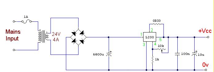

I built a bench supply using a typical L200 diagram which is commonly available across the net, but I've used THREE L200's now and I am pulling my hair out now trying to get this working.
I'll try to describe this circuit as accurately as possible...
I'm using a 24volt (4amp I believe) torroidal transformer fed through a full wave diode bridge consisting of 4 very chunky diodes which I think can handle the 4 amps. This is then fed to a 6800:mu: f 50wv capacitor. The current from this is then fed to an L200C regulator directly,the regulator is mounted on a very large heatsink (Which at no point has even been warm!). The external control components used for the L200 are 1k:eek:hm: resitor, 10k:eek:hm: pot, 0.33:eek:hm: Ilimit resistor and a 10:mu: f cap and a '104' cap on the output of the regulator. I know this is probably not relevant but the output is fed through an ammeter and on to a voltmeter, Both are analogue 'needle' type meters.
On first switch on I thought I had struck gold as it appeared to work immediately with no problems, The voltage from the rectifier to the regulator is around 36.4 volts DC and I was getting in the region of 3 - 30 Volts from the PSU. I only noticed there was a problem when I connected any load to the output, I tried pulling approx 12volt @ 200mA from it and the voltage dropped off to approx 5 volts, It appeared the regulator had reached the set current limit??? After a few checks I decided that the only thing causing this could be the L200 regulator so I changed it. It worked fine again and this time I immediately connected the same load (Approx 200 mA) and it worked well, I then spent 10 minutes using the power supply for the 'other project' I built this unit for, (Testing & setting up a couple of lead acid battery monitors based around the LM3914 bar chip.) Anyway, I was happy as larry at this point, I thought I was finished for the night but I then started to 'play' with the PSU I had just built. I stupidly connected a large solenoid to the supply which gave off a few sparks which promptly blew hell out of the L200 regulator, My output voltage shot up the the full 36volts which was being fed to the regulator. Obviously the regulator had gone short circuit. I again changed teh L200 and again all worked fine.
Now, I connected a load (Approx 200 - 300mA) to the PSU and decided to leave it running for a while as a soak test if you like. All went well for approx 25 - 35 minutes after which the LED's on the load began to 'blink' dull then immediately go back to bright, this would happen every second or two... I watched of the next 20 minutes and the problem got worse, The LED's eventually got duller and duller until they were hardly light at all while still blinking even duller occasionally. Now obviously the output voltage from the PSU was dropping gradually and again I feel the regulator was going into it's current limit routine.
I'm totally scratching my head as to why this thing is doing this, Obviously the second L200 was my fault out of stupidity but why is it behaving in this was especially after it worked well for a short period, Surely this says that the actual build quality is ok since it worked for a while?
Can anyone shead any light on this for me please as I am stumped by it now.
Thanks for taking the time to read this...

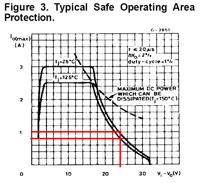

The only thing I can think of is the safe operating area protection is kicking in. When Vin-Vout > 16V the output current limit starts to fall to protect the regulator. In your case the voltage on the capacitor is 36.4V and the output voltage is 12V, therefore Vin-Vout = 24.4V which would limit the output current to 1A if the regulator is cold or 800mA if it's hot. I know you were only drawing 300mA but please note that these characteristics are typical, some regulators might cut the current limit at a lower Vin-Vout than others and that it's temperature dependant. This would explain why the first regulator you tried didn't work and the second one did but started to fail after half an hour, as it warmed up.
I assume the regulator broke when you connected the solenoid because the back EMF caused the output voltage to become higher than the input voltage for a short period of time. You can protect against this be connecting a diode from pin 2 to pin 1 (anode going to pin 2 and cathode to pin 1), this would provide a current path round the regulator so the transient would be absorbed by the input capacitor.

Now, I think I get what you're saying about the safe operating area thingy, BUT I would have thought it would supply 12V and only a couple of hundred milliamps??? It's bloody useless if it doesn't and I've wasted my time building the thing lol.
You assume correctly about the back EMF blowing the poo out of the regulator, Now I never thought about the diode across pins 2 & 1 but rest assured I will be installing it if I can sort out the main problem and actually make this PSU useful!

Here you go chaps, this is pretty much the Schematic for the PSU I have built!

If you want about 1 to 2 amps, use the circuit in the application notes that has a bypass power transistor.

Rsc is the sense resistor that deturmines the short circuit current.
Any circuit that reduces the power dissipation of the regulator will help solve your problem.
Another thing I've noticed is that the maximum drop out voltage is 32V. This means that when you set the output voltage to less than 4V it could damage the regulator.
