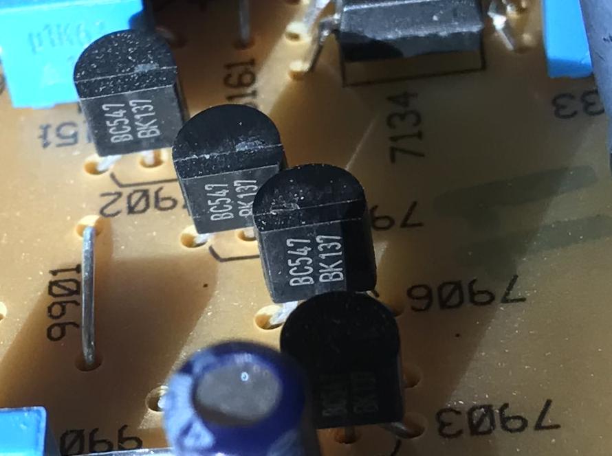

There are some inputs going it to the board (door, NFS and LFS) one of those been incorrect 'may' be telling the microcontroller not to feed the motors.
Each one of those 4 switching transistors above the fan & turntable relays, trigger each of the relays, and the last digit of each part ID# is the same as the last digit for each relay. The center terminal of the transistors, appear to be the bases for the transistors, which all connect up to the logic outputs of the main micro CPU chip. You could also probe each of these base terminals with a VOM red wire probe, (black probe to ground), to check for a small (0.7 volt) voltage change, to be sure if the CPU is sending a proper signal to each driver transistor for the corresponding relay. Transistor 7901=fan, 7906=turntable.

Attached is a pic of the upstream transistor markings and what I believe is the data sheet for that transistor.
  • BC546.pdf

Please also note, that by your attached documentation concerning the relays, these are 24v relays, and will need to be tested with a 24 volt supply, and NOT 12 volts as you had asked. You may possibly hear them click with 12 volts applied to the coil windings, but the contacts may not fully close with only 12 volts applied to the windings. If you already have the relays removed from the PCB, be sure to check if there are any spike transient protection diodes wired directly across the relay coil windings, (either mounted on the PCB, or internal to the relay), that may be shorted and NOT letting the relays fire. The 4 glass diodes between the MW relay and the TT & Fan relays, (6901, 6902, 6903, 6906), appear to be wired directly across the relay coil windings for each relay, and should be checked for a short or leakage, which would not allow a relay to fire. 6901 & 6906 would be the ones to check first!
I meant open - infinite resistance on the relay coil check. However I had scale set to x1 on a 5 digit digital display. Testing off board now on "auto" scale I get readings of 1.1 Mohms and 1,3 Mohms. I do note that as I leave alligator clips from the meter attached to the coil legs the resistance climbs (or falls depending on polarity of connections). The spec sheet gives a coil resistance of 2304 ohms so I reasoned that these relays are bad.
As to be sure I'm on the relay coil I'm testing across the pins that are in line with each other (not offset) because that is what the pictorial in the data sheet shows as the coil location. Other than that I don't see any markings on the relay to indicate which pin is negative/positive side of the coil, I don't know how to determine if there are spike transient protection diodes internal to the relay.
The data sheet relay contact wiring diagram does not show any internal diodes, but I have run across them before if the supplier possibly out-sourced the manufacture of their relays in todays world. Then I went back to look at the PCB trace wiring and posted to check the diodes mentioned. Be sure to lift, or unsolder one leg of the diodes to fully check the diodes for opens, shorts, or minor leakage; which also may have caused the relay coil windings to open; although unlikely. The diodes are mainly there to protect the switching transistor circuitry from back EMF from the relay coil windings.

No. The GLASS style diodes between the relays. 6901 & 6906. Reread my previous post.
The diodes couldn't be faulty anyway - and I don't think they ever fail? (unless you fit the wrong diodes).
If the diode was O/C the relay would still work, but the driver transistor would probably go S/C, leaving the relay permanently ON.
If the diode was S/C when the transistor turned ON it would short directly across the 24V supply, and would most likely kill the transistor as well, and almost certainly with clear visible signs.
It would also be pretty unlikely if two completely separate diodes both failed at the same time! :D
Depending upon the level of leakage, (and NOT a full blown short), if it were to occur in one of those diodes, (which I have experienced in logic board and other electronic repair), that could definitely pull the 24v supply to the relay, down below the 18 volts required to fully close the relay contacts; since the diodes are wired directly across the relay coil terminals. Without necessarily destroying the driver transistor, although it may become overheated; and eventually fail. I am just trying to cover all of the bases here, as it appears he HAS found, so far, at least one of the relay coil windings to be open. I am just giving him further things to check while he has the relays removed, and awaiting replacement parts, as there may have been a surge to this unit, that opened the relay coil windings. Without an explaination. Also considering that the control PCB has a SMPS. Otherwise, he may replace the relays, and then still find that the unit does not work properly.
