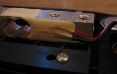

I've read the pdf and the censor is a load cell type shear beam. I still can't provide more info yet, but I will.
Here's a picture of the sencor.
As you can se there is four wires, Black, red, white and green.

But the provided pdf file only contains mechanical infos for assembling procedure. It doesn't answer my questions. That is: No electrical info about the load cell as censor is provided, and that's what I need.
you need the appropriate load cell amplifier for your load cell. Most load cells are wheatstone types. Since the signal levels are low, they need to be amplified.
You might buy a suitable ampilfier but I suspect they may be costly...you could also make an amplifier using op amps or use a dedicated load cell interface IC such as CS 5516/5520, but then you may also need a microcontroller to interface to the IC.
Try googling CS 5520 or CS5516

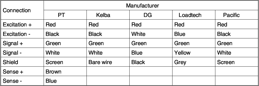

When I get time, I'll test the load cell assuming color codes in the table is valid for it.

On the one I have built from an $18 kit there are 4 wires only and no shield at all. The four wires feed to a board with an LED display . I would assume red and black are the normal power and ground lines and the voltages checked seem to verify this , so you only have to interpret the voltages on the other two

Hi. This weekend I managed to measure the voltages on the load cell while it's still connected to the circuitry (not pilled apart yet).
I can confirm that the color on the wires is correct.
However I measured the voltage difference (green/white wire) and it's very low voltage variation. Even one kilogram makes a voltage difference of only 0.4 mV.
