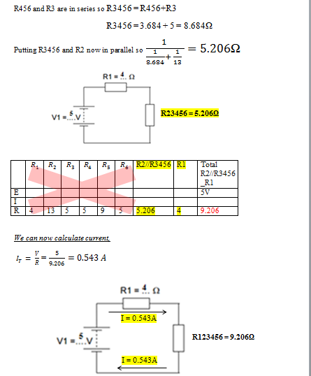

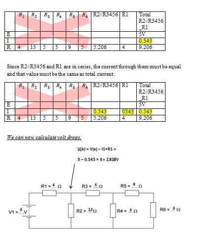

So here is the circuit, I am trying to figure current and volt drop through resistors.
I've got the circuit down to this by combining parallel and series. Also worked out total current.
I cannot think where to start with calculating the volt drops,

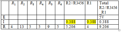

I have this table
Would I start by going back to the original circuit and first calculate E = I * R5//R6_R4? then do the same for each branch in the circuit?

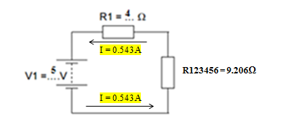

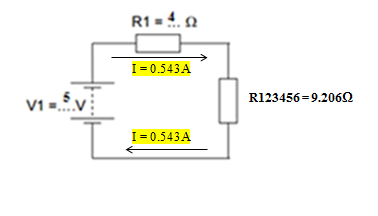

Doesn't the total current (0.543106A) flow in R1?
If you know the current in R1, then you should be able to calculate the voltage at the node where R1, R2, and R3 connect. Similarly, you can work your way to the right progressively for the remaining nodes. I would label them...
Your calculation of the magnitude of the current from the voltage source is correct, but I do not see where you got the values you put in the table.
Also, if you ever hope to get a real job in the Electronics Industry, then the current in R1 flows from left to right...

Your calculation of the current from the voltage source is correct, but you screwed-up when filling in the table.

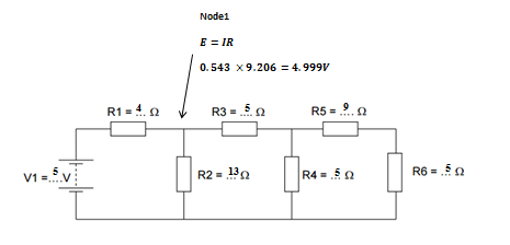

So this is the first node right?
Also fixed the table and current direction

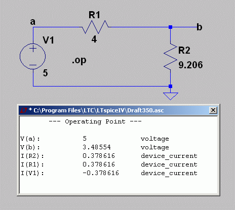

Note that your equivalent circuit is not correct:
Study this:
Do you understand why I put the current source where I did, and how that defines V(b)?

My equivalent circuit is wrong because it gives the wrong current right?
Correct.
You put the current source there because there the current will flow through the node?

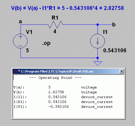

To say it a bit better: The 0.543A current source forces the current in R1 (and everywhere else in the circuit) to be the same as you already correctly calculated...
Note that you can arrive at V(b) by subtracting (I*R1) from 5.000V, as I tried to show in post #4. I only put the current source there so the sim could solve for V(b) without knowing the equivalent of R23456.

Okay so my equivalent resistance should be 3.486?

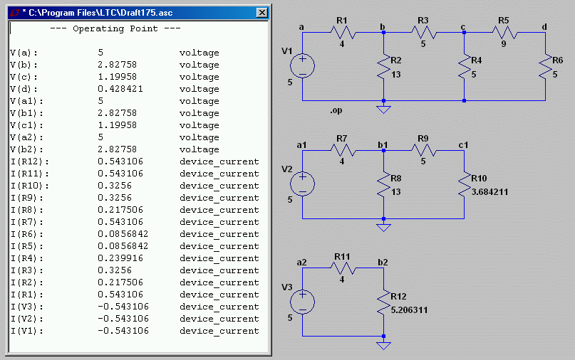

Here is my effort:

Here is the verification of the reduction steps:
e.g., compare V(b), V(b1) and V(b2)
I definitely went for the longer approach o_O You've helped my understanding a lot thanks

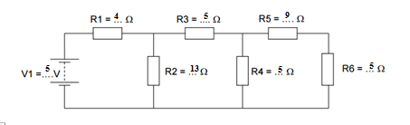

As for the currents of the remaining resistors, they're given right?
...How does I (R4) for instance = 0.239?
If its just I = V/R, then I (R4) = 2.298/3.684 = 0.624
I(R4)=V(c)/R4 = 1.19958/5 = 0.239916, which agrees with the tabulated value of I(R4). The current into node C via R3 equals the sum of the currents that flow to ground via R4 and R5+R6, or I(R3) = I(R4) + I(R5). We can find the current through the R5 branch the same way. I(R5) = V(c)/(R5+R6) = 1.19958/(9+5) = 0.0856842, which matches the tabulated values for I(R5) and I(R6). The sum of I(R4) and I(R5) = 0.32560, which matches the tabulated value of I(R3).

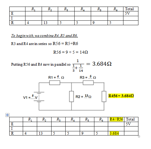

I have this table
There are a zillion ways to do this problem. Some of the ways are by loop, node, or branch analysis. Another way is the current divider law. For instance, the current present in R4 is I(R3) * (R5 + R6)/(R5+R6+R4). Since you already calculated the series-parallel values up the chain, they should be available for you to use.
