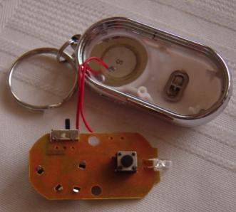

I purchased a key finder that uses a piezo for a sound sensor but it's way too sensitive.
Is there a way to reduce the sensitivity without altering the alarm tone or can a different piezo be purchased that is less sensitive?
It only consists of a switch,led, battery and piezo.

how does this locate keys? if it's something that works like ramussons described, you wasted your money.
Presumably theres also a blob on the board that does all the control work, not much you can do without affecting the beep volume.
Stuffing it with cotton wool will reduce sensitvity at the cost of some volume.

there is more to the device than was described... most of the circuit is inside that blob of glue. you could put a capacitor across the piezo to reduce the sensitivity by shunting some of the high frequency signal.
The key finder on the left has the capacitor, I used a 1944 U.S.N whistle to excite it.
The only issue now is a vibration fault as it will start when moved.
When the piezo is a microphone the capacitor reduces its high frequencies (the whistle) sensitivity but the low frequency (movements) sensitivity remains too high.
Also the capacitor should be a film type, not ceramic because a ceramic capacitor also behaves like a microphone.

I'll tweak it a little more but it has definitely made a difference by adding the capacitor.
The Electrolytic capacitor is working much better than the film capacitor as It knocks the high frequency down.
The film capacitor didn't have any affect on it.
A higher number of micro-farads cuts high frequencies. You said you used 0.1uF. An Oriental 0.1uF film capacitor is marked 104 and a European 0.1uF film capacitor is marked 100n. What marking was on your film capacitor?
It was a 102k that measures 1029pF.Maybe I need 100000pF?
Do these piezo sensors have to be encased to work?
When I removed it from the plastic enclosure it stopped working and when I reinstalled it back into the plastic housing it began to work again.
102k is 1000pF +/-10%. 0.1uF is 100,000pF.
I have never seen or used a piezo transducer.
They don't work uncased.
I notched the plastic in order to pry it out of the case with a screwdriver.
It wouldn't sense or sound out of the case and when I reinstalled it the piezo would trigger with sound but the buzz was next to nil.
I filled the notch with my glue gun and it's back to normal.
It requires a rigid mount around the complete edge of it to work properly.
