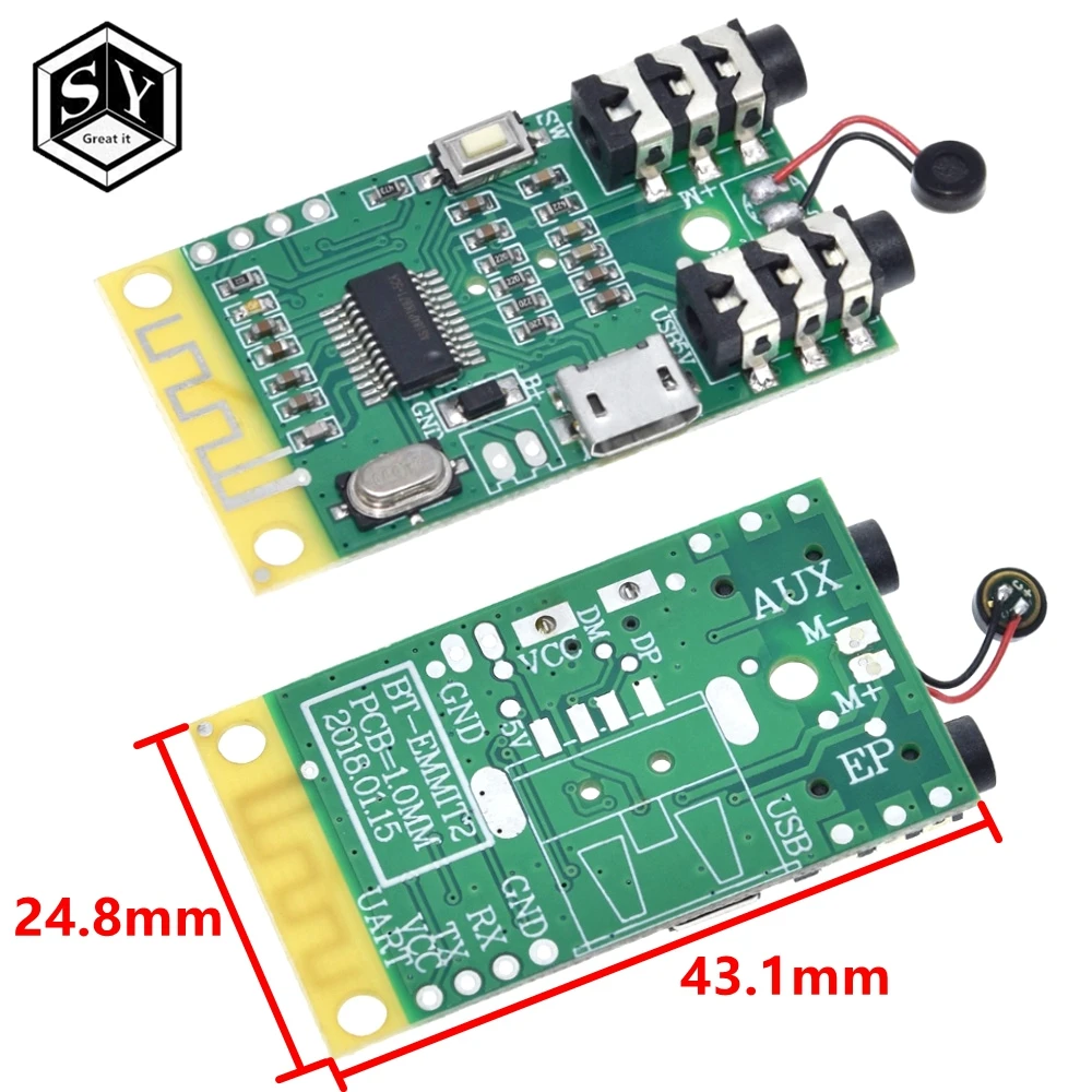

Do you know any Bluetooth modules that can be easily paired with each other and have audio transfer capabilities?
Hello all, I found this thread while trying to solve the problem of my kcx chip not connecting to a particular receiver. Thanks DrG and everyone else who contributed. I've learned a lot, and managed to speak to the chip via UART and a raspberry pi, but sadly while I can see the receiver, and command the chip to connect to it, it immediately disconnects again (I get the CONNECTED message, then a few moments later DISCONNECT). I have to confess, I'm drawing a blank. It seems like there might be some problem with the handshake between transmitter and receiver, but I'm hoping that enough clever people here have poked at the chip that someone might have a solution. Any ideas?
KES 205.00 18%OFF | Bluetooth 4.2 audio transmitter receiver board 3.7V~5V 10M Distance MP3 decoding wireless module Speakers diy 3.5mm for Arduino
