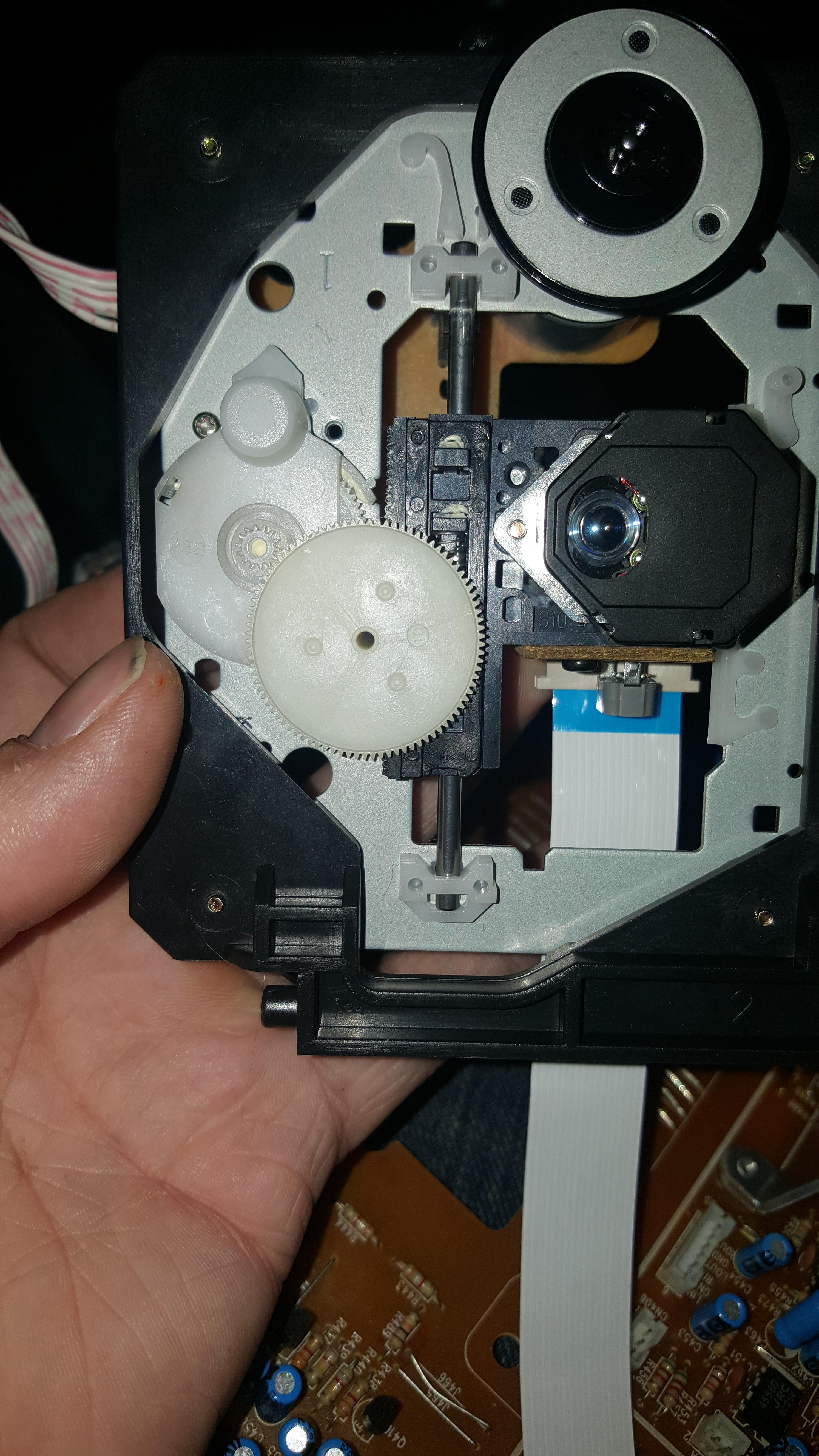

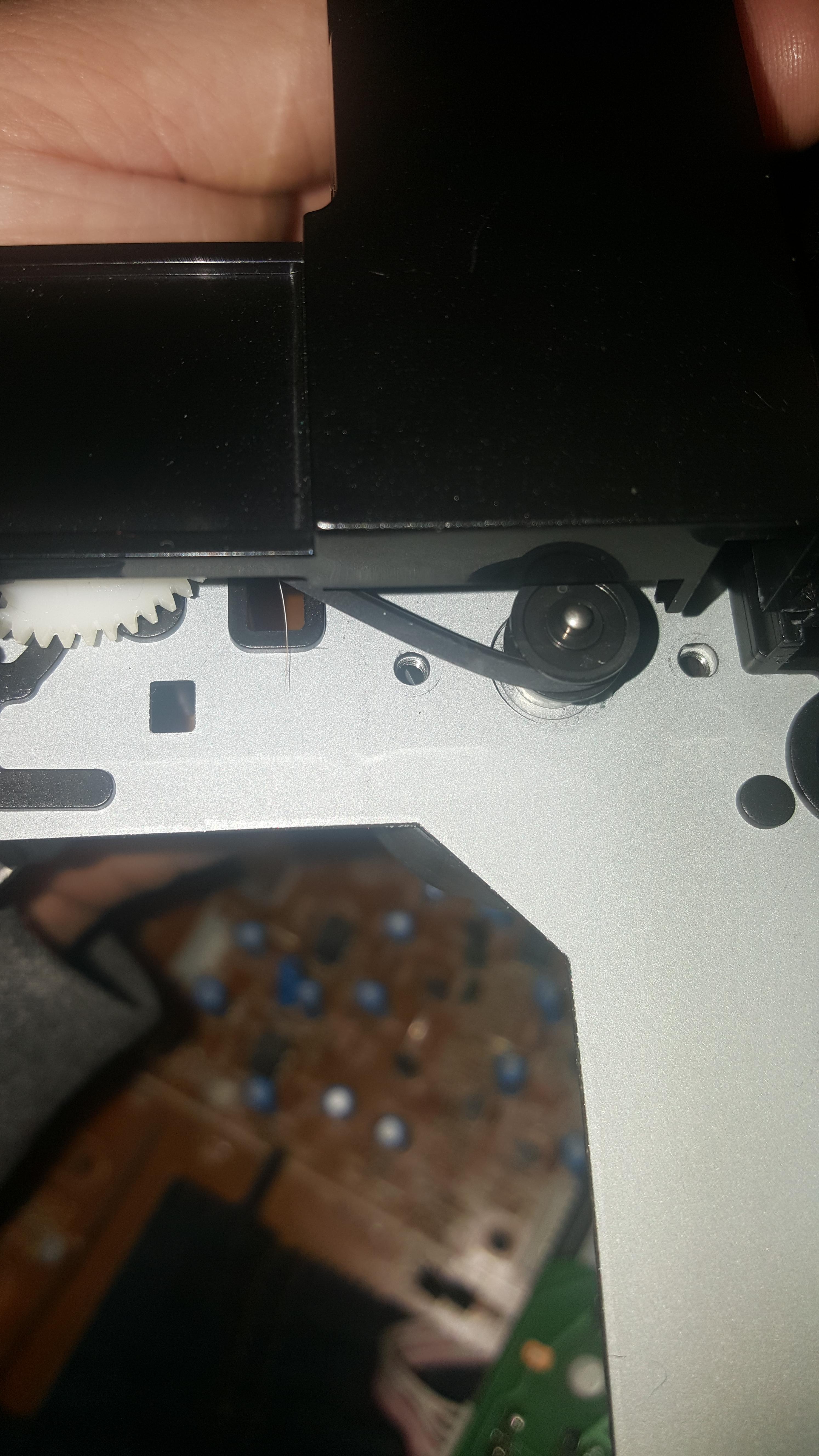

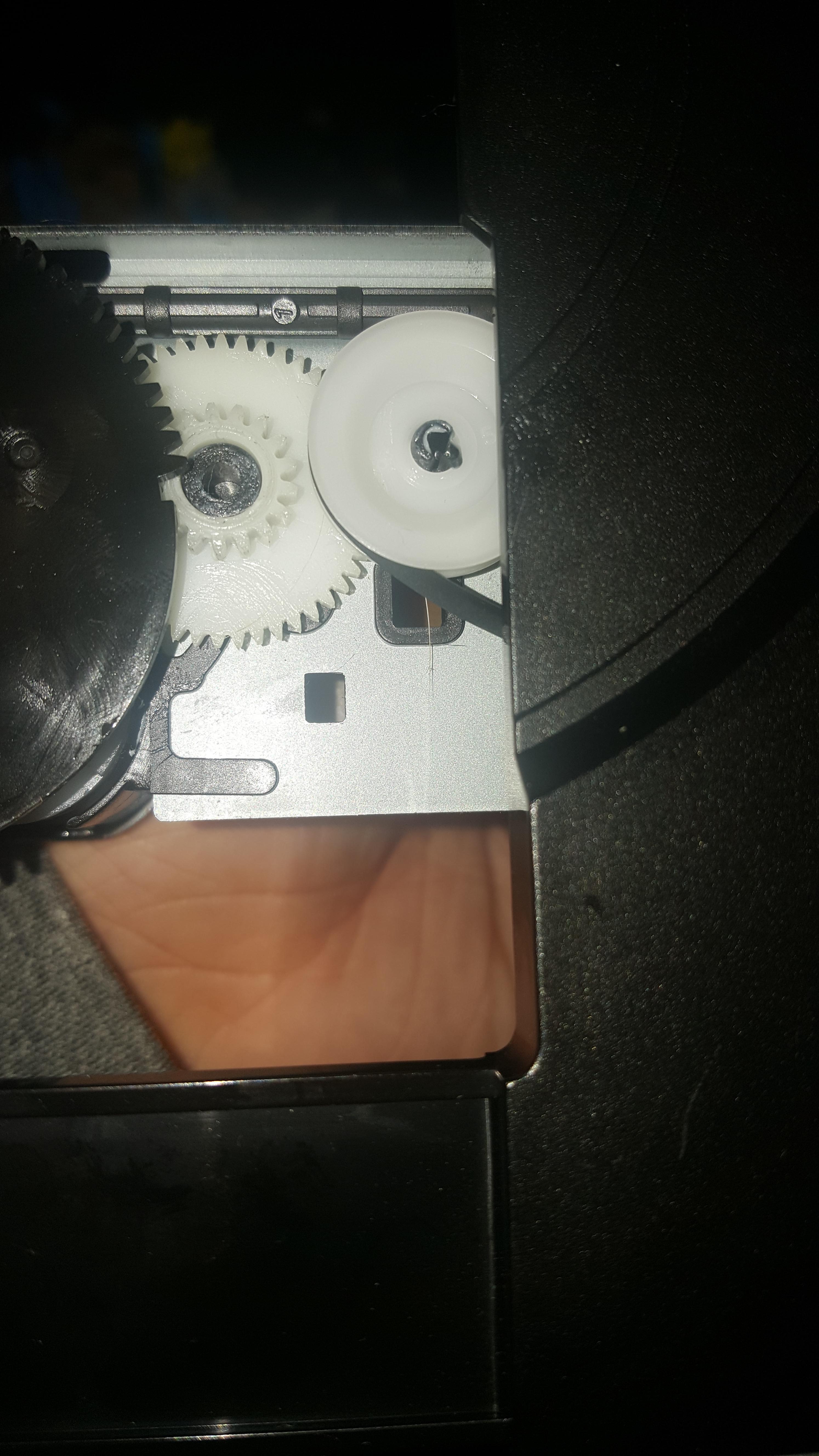

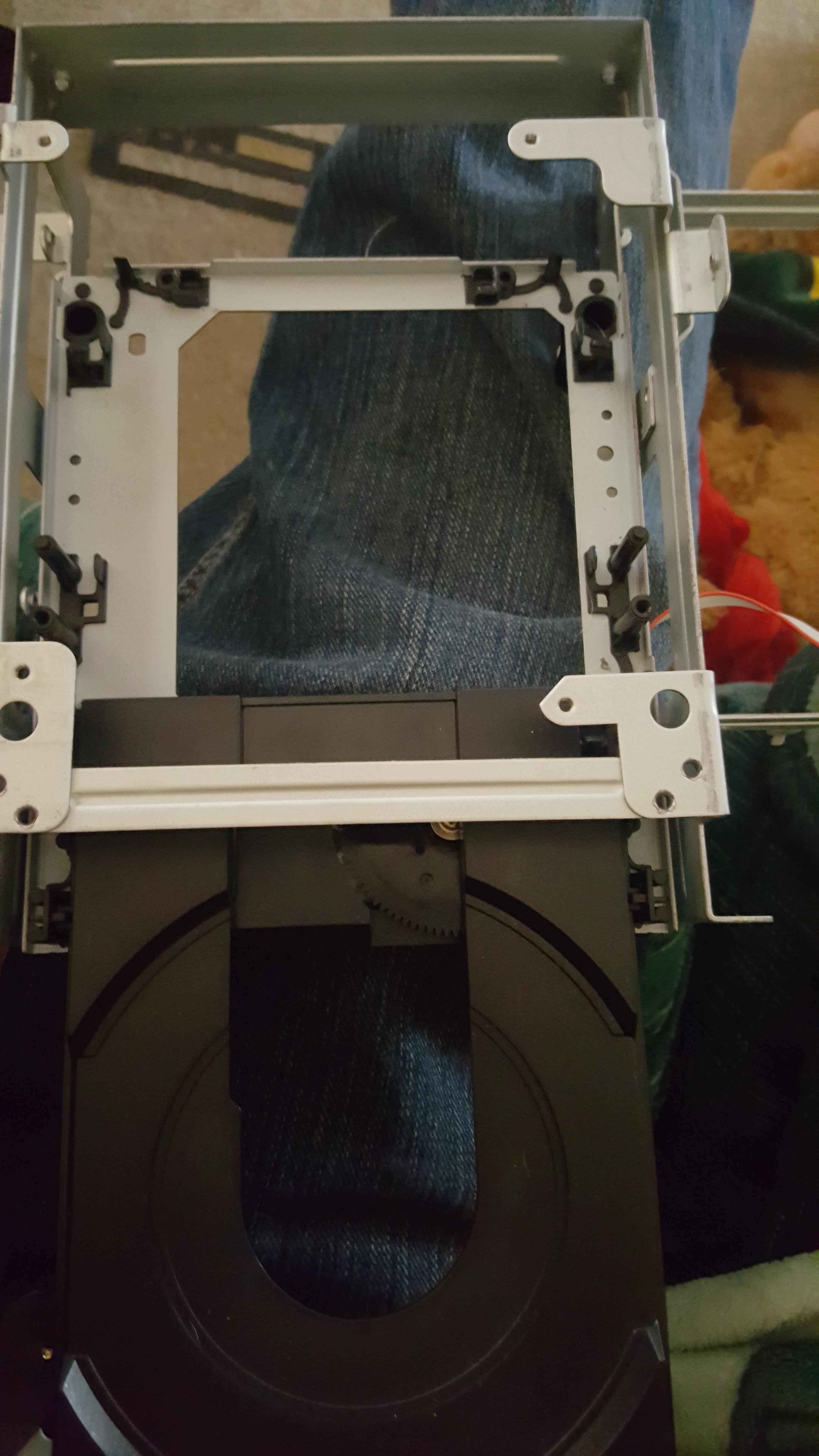

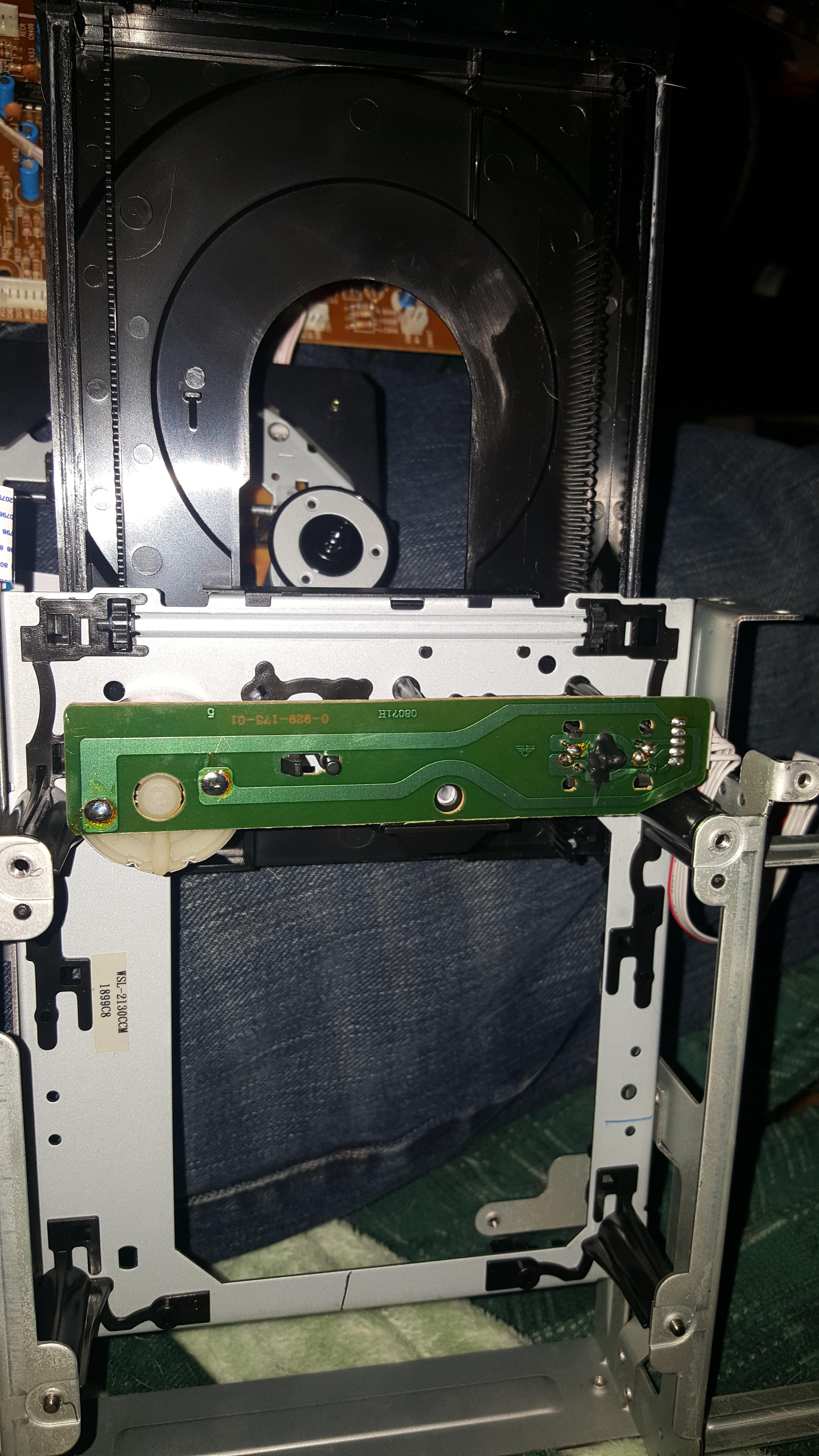

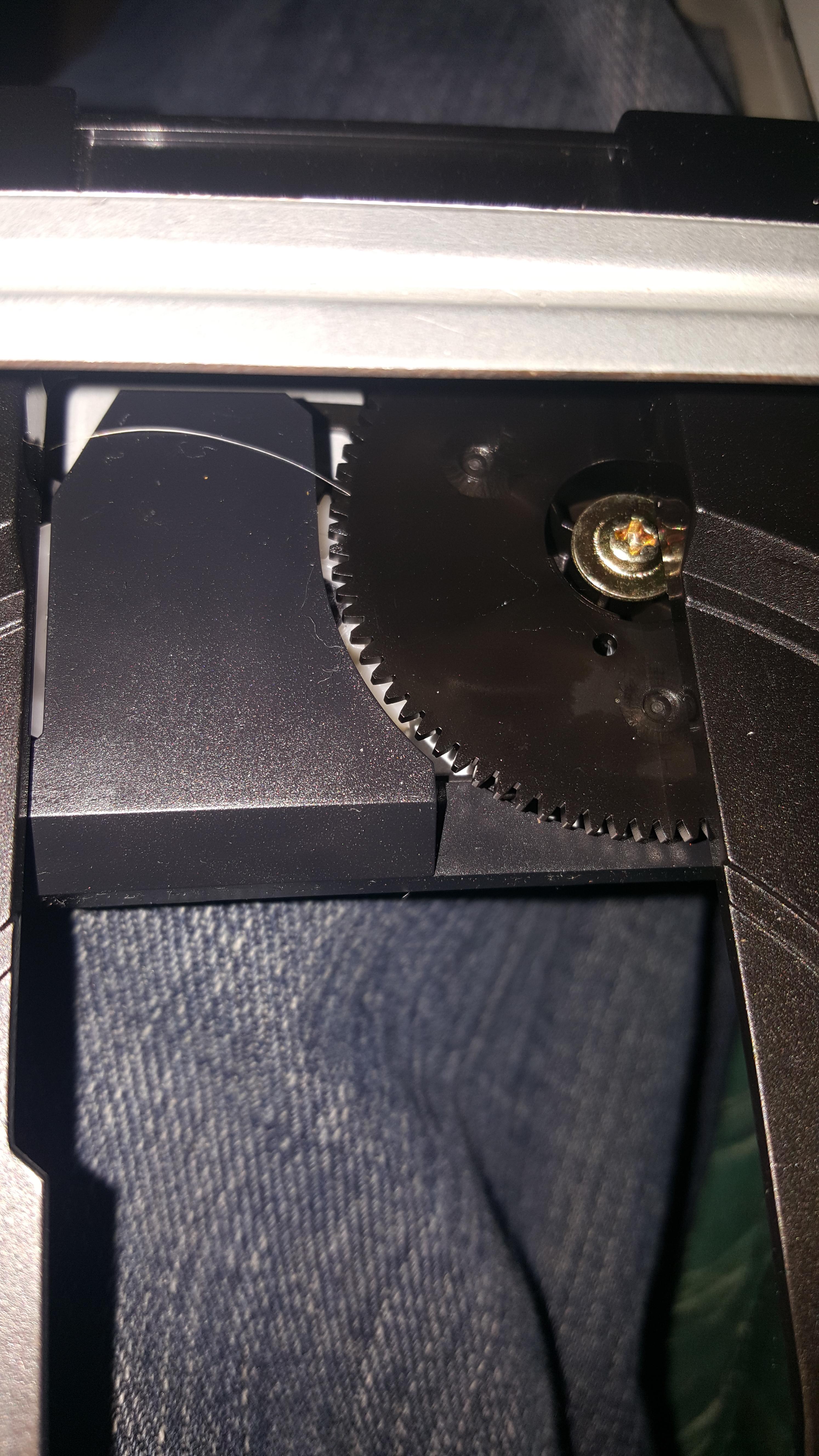

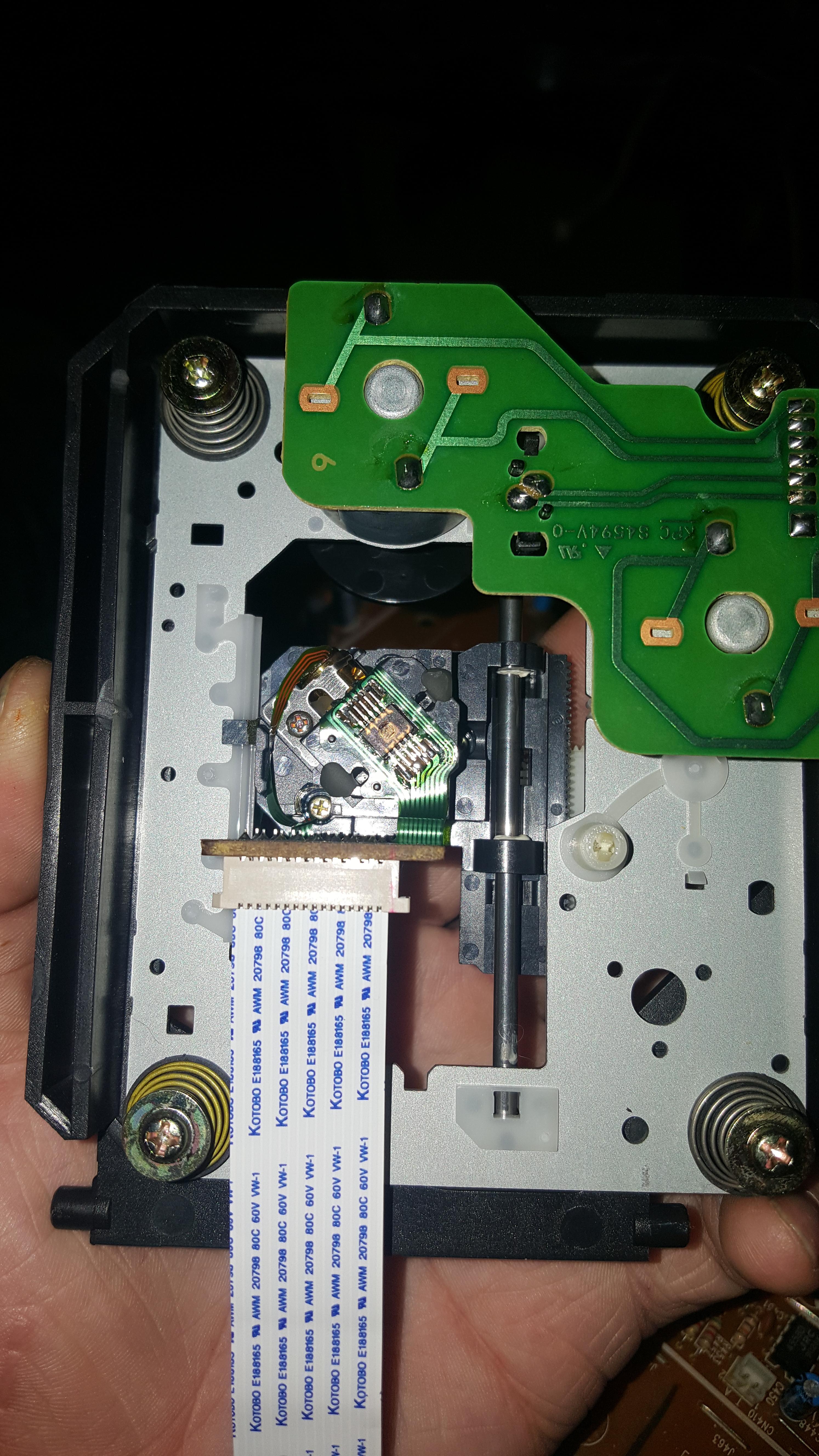

After looking for a belt on the drive, I found the belt. I have uploaded 7 images for your reference. Apparently the files are to big tof upload here.
The belt is not tight, not sure if it suppose to be or not. I can pull on it with almost no force. But I can also use the gears on the drive to move it in and out. Could this be a problem with the button on the machine?

It mustn't slip, or the fault you're describing happens - can you operate the draw mechanism while it's in pieces?, and see if it slips or not. I've just done exactly that on a Sony DVD Player, which proved the belt is slipping - I've yet to find a replacement though, although I'm not trying too hard as I've replaced the player with a BD one anyway.

The last picture clearly shows the belt, which is most likely the problem.
