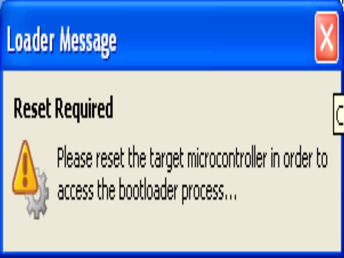

F10 is compile and program But like i said I could never get it to work with swordfish it doesn't see the PK2CMD as exe on my computer
It says programming successful
waiting for file update (click button again to exit)
Nothing on the Uart tool page
connected at 9600 baud

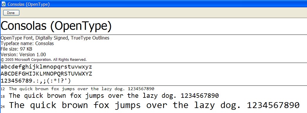

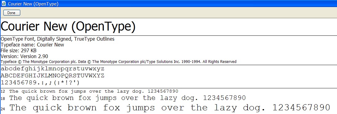

If you're having trouble with O and 0 looking too much alike, you should switch to a proper programmer's font. You're probably using Courier New, which does not have a crossed zero. It looks like this:
What you want is a monospaced font like Consolas or other mono font made for programming, with crossed zeros. You'll never mistake a crossed zero for the letter O. Consolas looks like this:

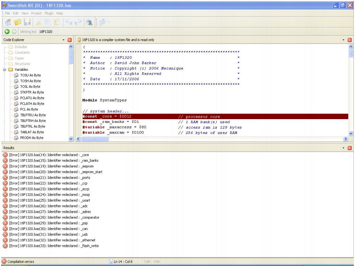

copied/pasted build succesful but errors
I copied / pasted the code then F10
it said build sucessful but I get several syntax errors and reset microcontroller.

As I said in an earlier post, use F9 - not F10. This will produce a hex file. You then use the PicKit2 programming software to load the hex file into your chip. As for the errors, you are not compiling what I posted earlier, you are compiling the include file.

I recopied / pasted then F9
all is ok
lots easier than mplab but now what??

If you have setup the PK2CMD.exe to work with Swordfish it's F<10> (compile & program). F<9> will only compile to a .hex file. You could use PICkit2 standalone software and load the hex file that way.
