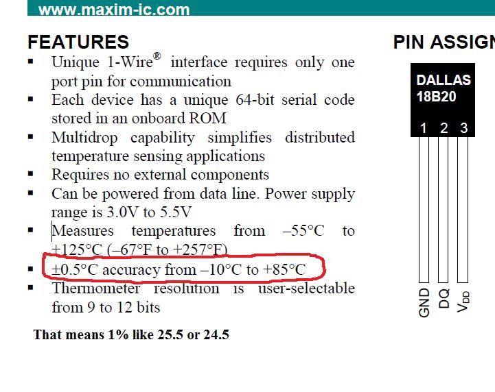

Plan to use a 1440watt Hot water tank element, a pump, and PID controller (home-built would be cheaper and more sataisfyting. Using the DS18B20 if I read all the 12 bits for temp, then the temp will display down to .065 instead of .5

Am I missing something concerning accuracy?
Plan is to try an build a PID using a PIC and a temperature sensor. Maybe the DS18B20 is not the desired sensor?
Contemplating maybe a thermocouple but can it be as accurate.
I only want a max temperature fluctuation of 1 degree.

.1% is better that .5 for sure but .0625 is better? at least that"s what the data sheet says on the DS18B20?
Digital output = 25.0626C = 0000 0101 1001 0001 or 0191h
maybe I is reading the data sheet wrong (read interpreting)?
Using the thermocouple would require say temperature compensation ic?
Have a look your missing something 25 could be 24.5 0r 25.5

Maybe I am missing something?
.5 degrees C = 32.9 degrees F
1 degree C = 33.8F
.9 degrees F accuracy
I assume IF you are reading all 12 bits
Hi Mr DEB, forgive me if i am wrong, but from reading this thread i think you have a slight mix up with the meaning of terms. accuracy isnt the same as resolution (number of bits).
the sensor your using is pretty much the same as the ones i use. the quaoted accuracy is 0.5c. wich basicaly means if you read the sensor and it says the temp is 32.5c then the real tempreture could actualy be 32c or 30c, resolution is the number of digits after the decimal point. for example you may have the temp displayed as 32.542457 but again the reality is the actual tempreture your measureing could be anything between 32c and 33c.
now in real life it dosnt matter much, i use theese sensors for running high end incubators where temp fluctuation matters a great deal, but i only read upto 2 decimal places i dont think there is any gain in reading more. also keep in mind you dont actualy read the sensor constantly. by this i mean there is always a delay of between 750 ms and a second. so you never actualy gets readings from the sensor like 32.532c 32.533c 32.534c what your more likely to get is a reading of 32.5 32.7 ect etc. bottom line is the reading MAY or MAY NOT be plus or minus 0.5c from the actual tempreture.
hope this helps
