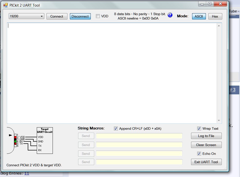

I discovered how to use the usart as a debugging tool BUT can only get it to work with the PIC on the Junebug
Have a ICSP pluged in between the Junebug and target project.
Have ALL the dip switches OFF
using Pickit2/ Junebug I write to target
When attempting to SEE what the target PIC is doing I get nothing.
Turning ON the TX dip I get wahats ON the Junebug PIC not the target.
Using the HELLO WORLD code but changing to HELLO DOUG
the Junebug has HELLO WORLD
What am I missing?

The Serial Tool GUI has a diagram that shows you where to connect the TX pin to make it work. But know that it can not be that way when programming. You need a switch or jumper block.
If you look at the JB's schematic you can see how Bill did it.

Under tools Menu in PicKit2 GUI
uart.jpg**broken link removed**

if i have read your post correct................you are trying to display to the usart from another board not the junebug, is that correct?? from the very little i know (and it is a tiny amount!) you will have to power the circuit externaly not by the bug and connect the TX of the target chip to the RX of the bug and the RX of the target chip to the TX of the bug, sorry if i have totaly misread your post
on the 1320 the TX is pin 9 (RB1) Bottom left hand pin. RX is pin 10 (RB4) bottom right hand pin
That makes sense, externally power the daughter board.
Will give it a try but first need to find out what I need to do to power the daughter board without damage to the Junebug?
Hopefully this is correct?
from con8 pins 6 & 7 to daughter board pins 9 & 10 (18F1320)
and pin 8 to ground.
You should start reading and try to learn Basic. I have tried to help you but you haven't learnt anything. Start reading.
ok i havnt tried this but i think it goes like this..................
power the daughter board from seperate source, but connect the Gnd with the Bug Gnd, then from the ICSP connector on the bug connect the pin thats marked PGC (this is RX also) to the TX pin (pin9) of the target chip and connect the PGD (this is TX) pin of the ISCP junebug connector to pin 10 of the target chip, make sure you dont have PGD and PGC connected to pins 12 and 13 of the target chip at the same time like you would do when programming the chip. i think you also need all the bug dip switches off but you might need to play with that. hopefuly if i have it wrong pommie or 3v will correct me.

The reason you don't see anything is because by the time you run the uart tool your program has wandered off into random memory. You have a for...next loop which sends 100 followed by 200 and then nothing, not even something to stop it executing random memory.
Here's a "Hello World" program for the UART.
Device = 18F1320
Clock = 4           // 4MHz clock
Config OSC = INTIO2, WDT = OFF, LVP = OFF
include "USART.bas"
OSCCON = $62        // select 4MHz internal clock
ADCON1  = $7f       //all digital
INTCON2.7=0         //turn on WPUs
USART.SetBaudrate(br9600)
While true
    USART.Write("Hello World!", 13, 10)
    delayms(500)
Wend
End
Note the while....wend loop that is always true and so will carry on forever.
