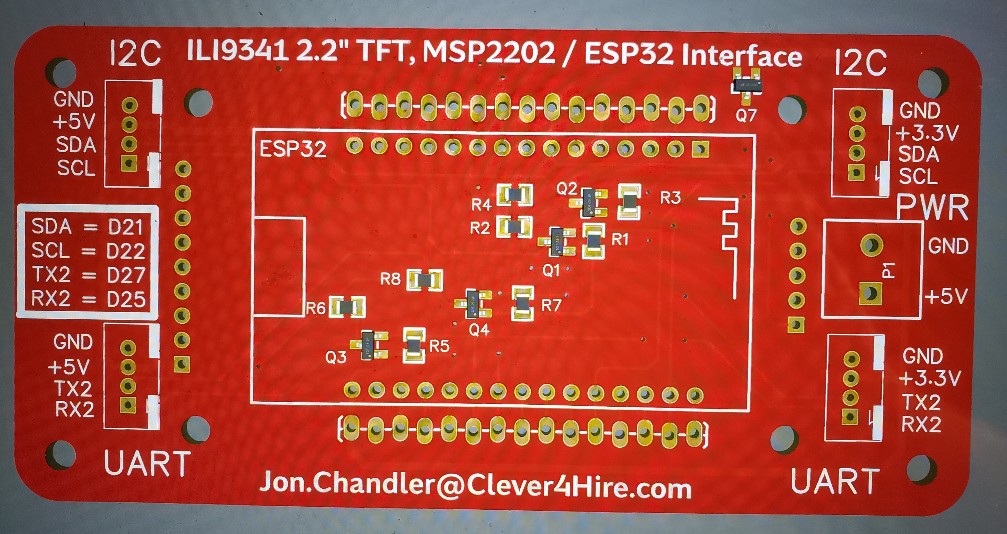

I've starting playing with ESP32 modules and TFT_LCD modules and can see great utility in the combo.
I wanted to build a PCB to marry a 2.2" 320×240 ILI9431 module to an ESP32 dev board and decided to include I2C and UART pins for I/O with level shifting to provide 3.3v and 5v connections. These interfaces are wired out to Seeed Studio's "Grove" connectors and Elecrow's "Crowtail" connectors, which seem to be a somewhat of a standard for sensor and other type modules.
The lever shifters are a simple circuit using N-channel mosfets and a couple resistors per channel. I also included a P-channel mosfet for input power reverse polarity protecrion. The board is pretty simple, with a total of 5 mosfets and 8 resistors. I decided to give JLCPCB's assembly service a try.
For those who haven't heard about this, if you design around their preferred parts, assembly is almost free, as you'll see in a moment. "Basic" parts are common parts that they have loaded on rows and rows of pick&place machines. You can also use a limited number of "extended" parts, which are less common parts the LCSC has access to but which aren't normally loaded on the P&P machines. I designed around "basic" parts, but couldn't find a suitable P-channel mosfet in their basic or extended offerings.
I uploaded my Gerber files, BOM and centroid files to JLCPCB. Here's the price breakdown to have 10 boards fabricated, a stencil made, and the surface mount components soldered to those boards:

The limitations:
¤ Only green soldermask may be used for assembly
¤ The service covers only surface mount parts that are in their system.
¤ They will assemble one side of the board only.
¤ There is an up charge for "extended" parts.

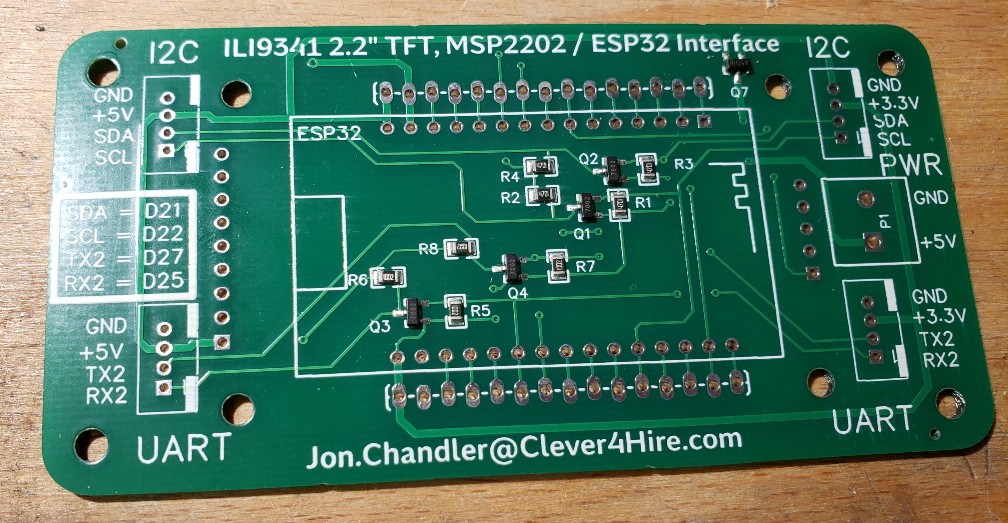

The solderpaste stencil is cut only for the parts they will install, so the pads for parts you must install are virgin, without any solder left over from the assembly process.
These boards wouldn't have been difficult for me to assemble myself but this low-cost service does open up the possibly of using smaller components than I can deal with.

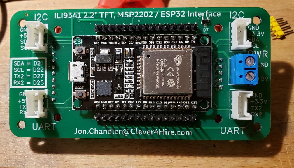

I received the assembled boards Monday but I was out of town until last night. The boards look great, and are as expected.
I was going to install the ESP32 module with sockets but I decided to solder everything directly to the board. This picture shows the back of the assembly with the ESP32 module, and "Grove" connectors for 3.3v and 5v I2C and UART connections. Several of the Chinese suppliers are using this connector for sensor and other modules.

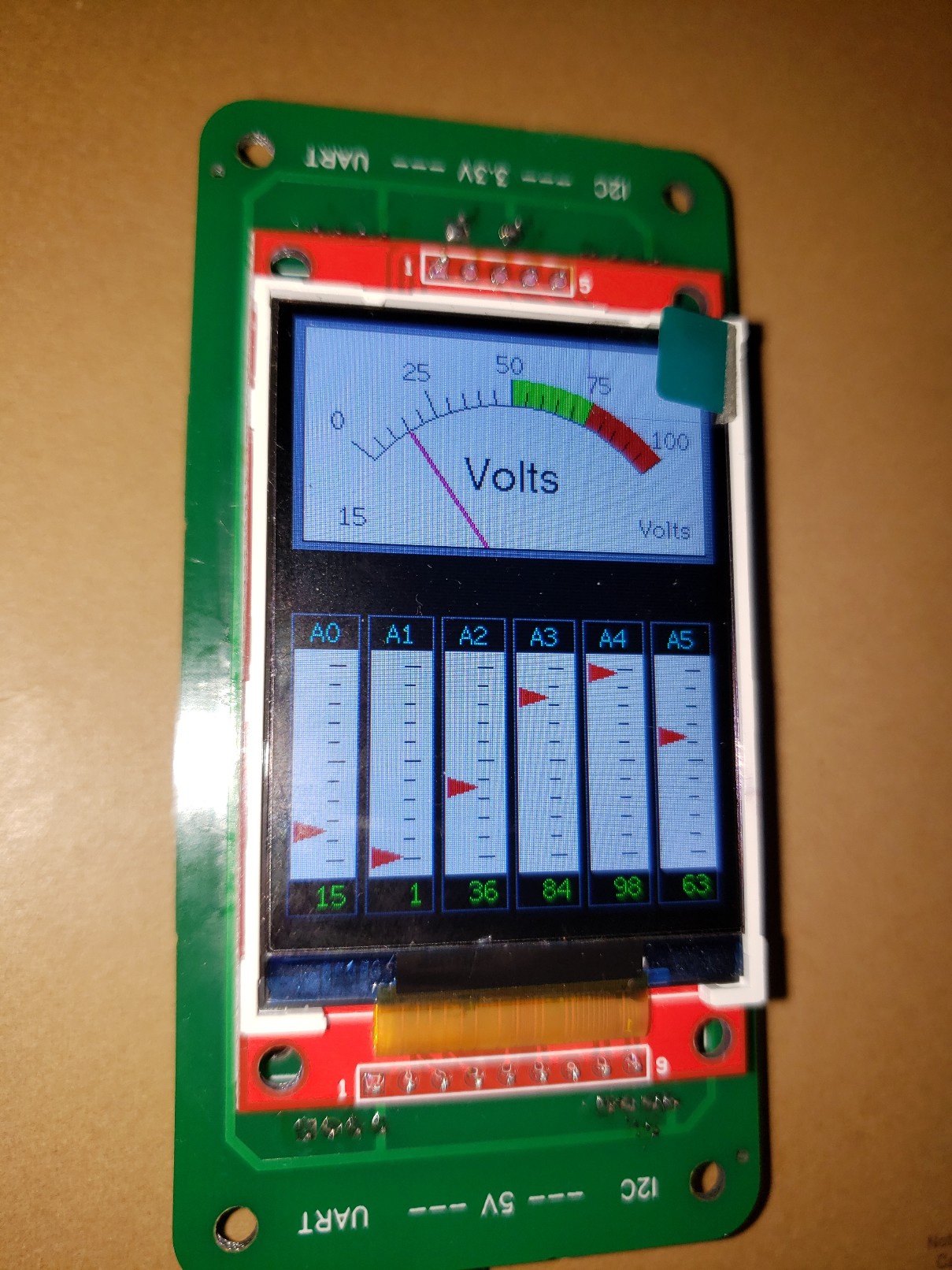

Here's a picture with some example code running. It's hard to believe how sharp and clear these displays are. This is a solidly-constructed module with no jumpers needed for the display.
The only issue I had was remembering that the LED backlight is controlled by a pin and isn't hardwired. There were a few "oh crap" thoughts when I loaded my code and nothing appeared to happen!
I've had exactly that same TFT demo running an an ESO32 as well :D
Great pictures on the displays, and pretty fast with an ESP32 as well - I've had the displays, and the same demo, running on a number of different devices, and the ESP32 was probably the fastest?.
BTW, I liked the way you spaced the UART and I2C sockets apart so they cleared the USB socket and the lead can plug in. It's the sort of thing you suddenly find out when it's just a 'little too tight' because you didn't pay enough attention.

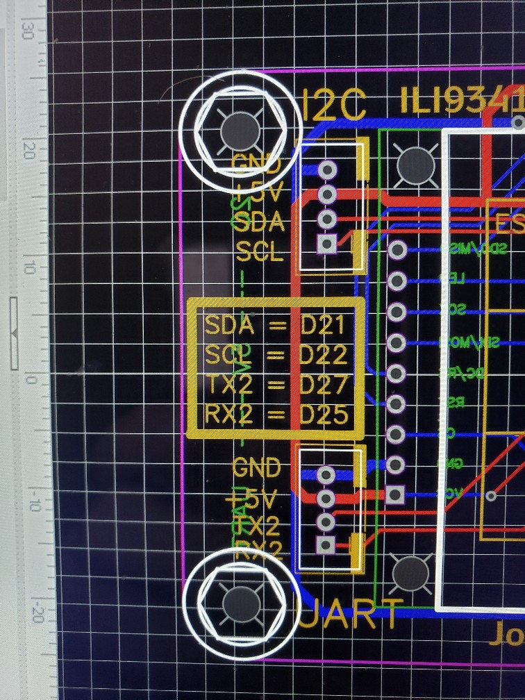

I try to think about things like that...not always successfully! ;)
Another area I used to have problems with was clearance around mounting holes. I solved that problem by creating a mounting hole "component" that has a 3.2mm hole and in the document layer a circled outline of a nut (to show the clearance needed to turn the nut), and a larger circle showing the space needed for a nut driver.
