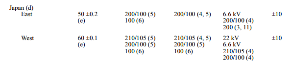

Google says that Japanese mains voltage is 100VAC. Though obviously there will be some tolerance. Is it possible that Japanese mains could be at 85VAC for a few hours each day?
This source says the variation around 100V is ±10%: http://www.hyvac.com/tech_support/electrical_sources_worldwide.pdf
We don't know if those limits represent a coefficient of variation or some absolute range. I guess if it dropped to 85V, you could sue them. ;) As I understand the Japanese legal system, loser pays all costs.

thanks for your linked document, which says Japan mains is 100VAC +/-10v.....but our senior engineer tells us that Japan mains will virtually never be 10v down...he reckons its +/-5V and no more....who do we believe?
JpanHalt:
Are you really serious? - the SPECIFICATION is +/-10V (+/-10%) - in practice it's likely to be considerably better than that.
thanks but our equipment runs 12 hours solid per day, if the supply drops out for just a few seconds (goes down to 90VAC for just a few seconds per day) then we get sheets of non cured ink going through the machine, which really is not wanted.
In that case you need to design your machine better - or 'hope' that it doesn't drop too often.
If you have specifications, then you need to design to them (or better still, exceed them a little).
