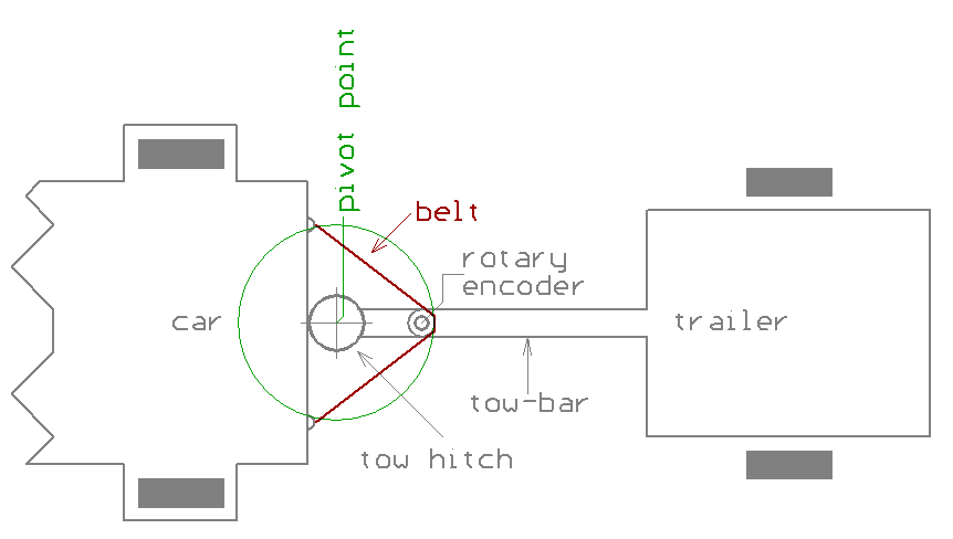

Hi Brownout,
the idea using a rotary encoder was not the worst at all.
It is accurate and easy to use with an MCU to calculate for the off-angle.
Here is my mechanical suggestion:
Use a tooth belt (as used in some car engines for the valve drive) and connect it from side to side of the towing car running over the sprocket driving the encoder.
The pivot point and the suspension points for the belt must be in a perfect circle not to lose tension of the belt as the tow bar gets out of line with the towing car. For easy removal use clips to connect the belt to the car.
I guess the rest is self explanatory. The electronic part is a piece of cake if you know how to write the software (I don't :))
Regards
Boncuk
Thanks Boncuk. The description made me feel goofy, but the drawing cleared it all up.

how about a laser diode generating A vertical line, shining back at the bumper from the tongue. Then have a detector on the bumper at each end, if the laser paints either sensor, you are about to jackknife.
you could have multiple sensors in a strip if you want to sense in steps.
Great idea!
I know you meant "horizonal" line. I get that mixed up too.
No, I mean vertical. the vertical (up & down) stripe would travel back and forth on the bumper, hitting the sensors. If it was horizontal it would hit all the sensors all the time.
Use a line instead of a point to allow for up and down misalignment of the trailer and truck.

Why not use a potentiometer to measure the angle? Mount if ahead of the towball with an arm (think RC servo horn) out sideways with an RC ball linkage to the trailer. Or, mount it below the towball with a slotted linkage in line with the trailer, the trailer would need a downward facing pin to go into the linkage. A simple window comparator would give you the warning signal.
