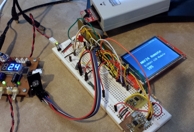

I'm assuming ILI9327 is similar to the ILI9341 which are all over ebay. The arduino shield ones all have a 3.3V regulator on board and are using the 5v power regulated down for main power. There is some discussion with using 5V data lines on these and it is out of spec, but it looks like it works fine as there are a lot of these and I don't believe they are level shifting the data lines.
If this is using a regulator on the power line and you are powering it with 3.3V, the voltage drop over the regulator might be underpowering it.
The ebay ILI9341 ones are one of my favorite displays, but I avoid the arduino shield versions.
