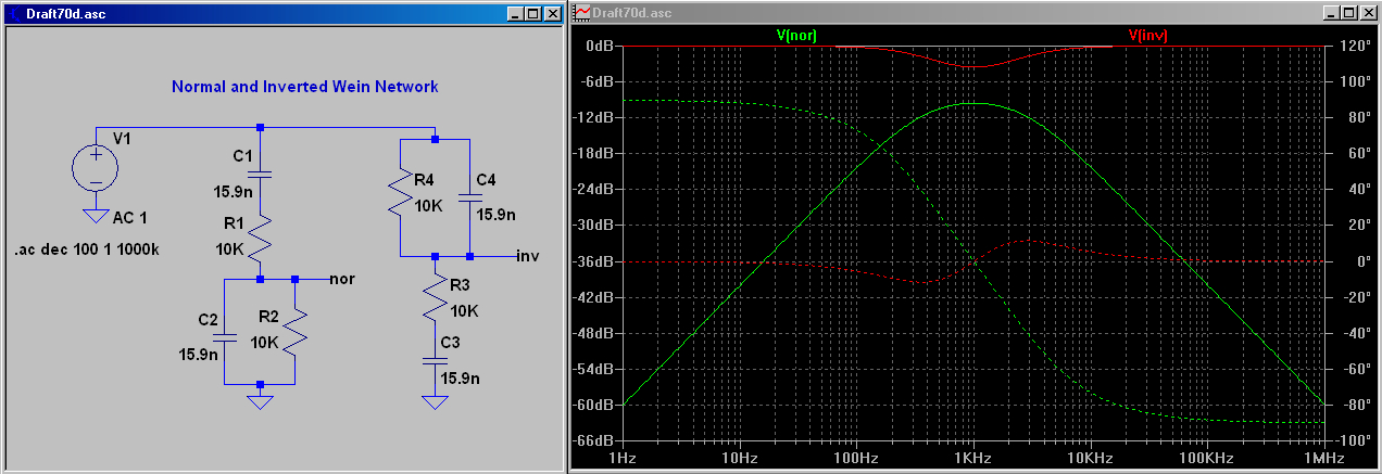

I thought we were done, but you seem to want to keep ignoring the nail ;)
Look at these two Bode plots. My experience tells me which one I would choose if I was trying to build an oscillator.
Which has an unambiguous single frequency where the phase shift is zero?
Which has a single frequency where the insertion loss is at a minimum?
I'm not sure if it is significant, but which network has a negative slope in the phase shift near 0 degrees?
OBTW, I simed the simplified Inverted Wein network in an oscillator. It oscillates at DC (latches up) at Loop Gains between 1.00001 and ~1.0007. For 1.0008<LG<~1.01, it oscillates with saturation at about 100kHz, but the frequency is greatly affected by LG. For LG>1.03, it oscillates as a square-wave multivibrator, like a 555... What a crappy oscillator!
Mike, thank you for your response, but please take into account that my mother tongue is not english. I couldn`t find out what "ignoring the nail" means.
I am afraid, you didn`t get the main point of this thread. It is not my aim to find a suitable passive circuit to be used in an oscillatory network.
However, perhaps this is a new information for you, but even the inverted Wien circuit can be used in a feedback oscillator. However, it must be placed in the inverting loop!
An insertion loss that has a minimum at a certain frequency is NOT an important criterion for a feedback oscillator. That has been proofed. There are lot of counter examples.
[/QUOTE]

Hi Steve,
I am not sure what you mean when you say that the standard Wein works beautifully and the inverted Wein latches up.
Are you aware that the resistors R5 and R6 much also be swapped for the inverted version?
In other words, if the standard version has R5=10k and R6=5k, then the inverted version requires swapping R5 and R6, so R5=5k and R6=10k. It's only then that we see similar action.
Oh yes, before i forget to mention, since i was offering as another specification (in addition to Barkhausen) of an excitation by a frequency equal to the zero phase frequency and that of course is a frequency domain specification, i should have also included the time domain version of that which could read that the state of the system be equal to a valid state as when the oscillator is already in motion. In other words, the initial cap voltages can be set to equal any measured voltages of these two voltages at any time t once the system is up and running. So for example if at time t1=100 seconds we measure vC1=A volts and vC2=B volts (not random voltages) we should see the system start up smoothly. Of course if either of these voltages is not correct, we'd then be doing the equivalent of applying a step to one of the initial conditions and that would mean it would start up too, but that's cheating because that does not narrow down the start up requirement good enough (using a step means using a bunch of frequencies not all of which are useful).
I was also assuming we were going to be working with sine oscillators to start with.
