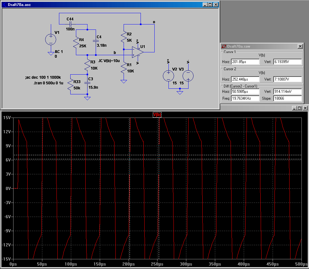

Well, here is what happens when I closed the feedback loop. The damn thing is running as a multivibrator; not a sinosoidal oscillator...

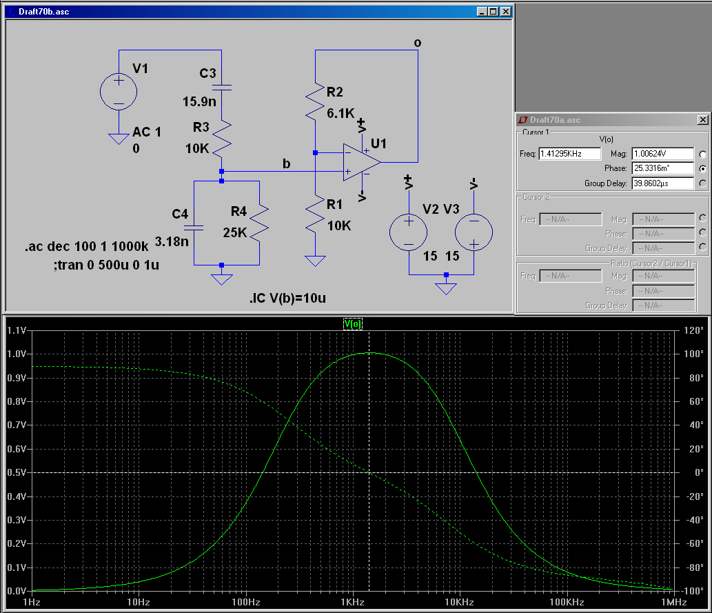

If you turn the Wein network the way it is usually used, here is the gain/phase plot. Note that I removed the extra cap and resistor, and tweaked R2 to get a loop gain slightly higher than 1. Note the well-behaved Gain hump, and only one place where phase is zero.

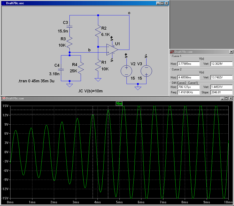

Closing the loop turns it into a decent oscillator, except that the harmonic distortion is terrible because the opamp runs into the rails...
Winterstone, if you had just posted your circuit with your very first posting to this thread, you could have saved all of us a whole lot of trouble...
Its not about the nail!
Hi Mike,
I think you can use either one. But with the one more often shown on the web, the resistors R1 and R2 would have to be exchanged in order to get rid of the exponential part (and thus remove the damping required to make an oscillator).
When all the values are the perfect required values the theoretical oscillation is perfect and requires no non linear network. Simulation would show this as a very very long chain of sine waves before they either start to get larger or smaller.
Note that with R4=R3 and C4=C3 the analysis gets much more simple too, which is nice.

Oh you are awake too now? I dont know what time it is there but here it is quite early yet :)
Yes i think it would work. I could double check if you still have doubts, but in the analysis of the ideal circuit gives me:
Vout=-3*sin(wt)
for a step change input which is clearly a sine wave.
The other circuit (more common on the web) gives:
Vout=6*sin(wt)+3 which has a DC offset and is 180 degrees out of phase with the first, but again a sine wave
Note this is pure theory again, but what this means is that in real life this should be a workable design. Are there flaws in doing it this way? I dont know all the ins and outs yet.

So you dont want to use equal components? So components are right now:
R1=10k
R2=5k
R3=10k
R4=20k
C3=15.9e-9
C4=3.18e-9
C44=100e-9
R33=50k
But i assume you would prefer to see the analysis without the extra R33 and C44 right? As they are only required for the simulation right?
According to my theory about the damping:
z=C4*R2*R4-C3*R1*R4+C3*R2*R3
for your choice of values, z is negative and significant, therefore the pole pair is deep into the RHP so the output might shoot up or down quickly and saturate without some sort of non linear limiting. However, solving that equation for R2 gives us something to work with:
R2=(C3*R1*R4+z)/(C4*R4+C3*R3)
and setting z=0 we get:
R2=14.285k
which would provide a better starting point.
But the short answer is that the circuit will not oscillate because the pole pair is too deep into the RHP and that causes the output to saturate quickly. Limiting might solve the problem though.
I have included C44 to stop positive dc feedback (otherwise problems with a fixed bias point - in simulation and, of course also in reality).
This makes R33 necessary to allow the dc bias current for the p-input of a real opamp model (simulation and reality).
