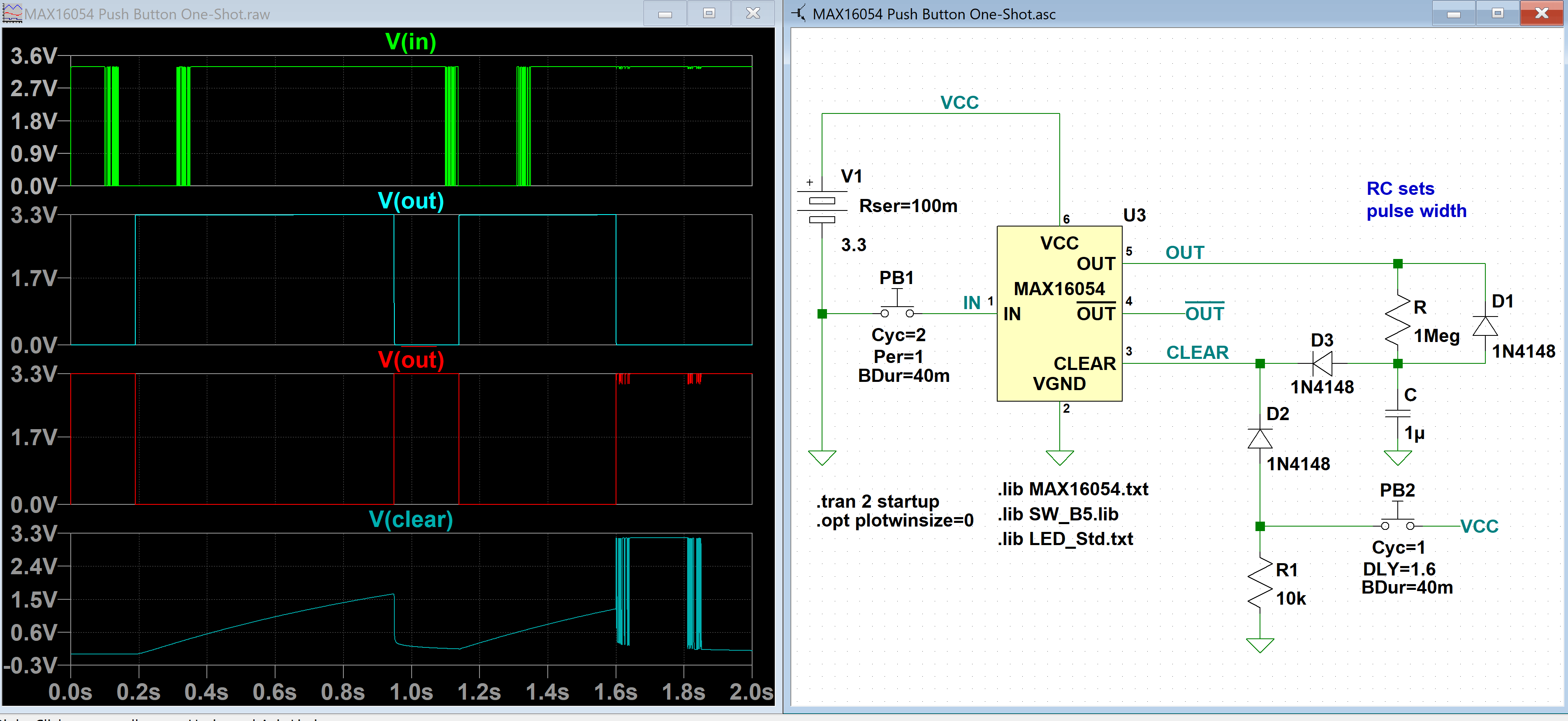

Here's a one shot version of the circuit I posted earlier.
The timing can be canceled by the clear button.

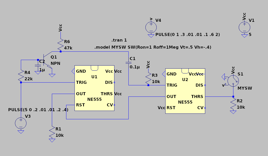

Hah! Done it.
I tried a 4013 and found I can't get sufficient logic levels with a LDR as the input, so played with the original design, discovered some things I didn't know about 555 timers, took a lot of stuff out.
So now U1 works the same as before, but U2 instead of the toggle function acts as an inverse output set/reset latch with Q1 providing the negative going trigger (to reset it high) when the input event finishes. Pressing the cancel switch sets the output low and resets U1. C2 stops a blip happening when the input event finishes, if the cancel switch has been pressed.
(edit) So I think I'm going to use this one, with a 556. Thanks very much for all the suggestions, everybody!
