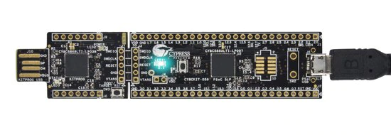

This might be of interest -
Its a single chip solution, has ARM core, and many other resources. The approach shown uses
no CPU intervention, all done with DMA and DAC.
IDE (PSOC Creator) and compiler free. Low cost $10 board to get started -
Regards, Dana.
Regards, Dana.
At first sight I tought it was just publicity of something different, now I saw it better, I'll see what it is about, Can I generate the 5 KHz triphasic signal with it and stop or initiate it from the 18F4550? Thank you for your answer
Yes on start and stop, trivial to handle. If input is mechanical with
bounce also use its debounce internal resource. It can be as simple
as an HW enable choice in DDS to a sync of waveform to stop at
a a particular sample value.
If needed changing the freq over a serial link would be easy as
well, just sending a command from Microchip to PSOC and
changing the DDS freq.
Note the output of the Wavedacs that create the sine are unipolar,
so if you need bipolar you would AC couple them. Additionally the
Wavedacs can generate anything, and have some other standard
forms like Tri, Ramp, Square, arbitrary....
Regards, Dana.

This is an example gating sine in a burst, eg. the control. In this case the burst
is synchronous with the start of the sine sample set. Counters are used to count
the total number of waveform samples, hence cycles. Again single chip solution.
This is more control than you asked for, just an example of what can be done with
a SOC type part.
The # samples / cycle is configurable in the Wavedac. In the example link I showed
earlier used was 100 samples/sine wave cycle.
Here is an examination of sinewave distortion versus sample set size -
Checkout the right hand window in IDE, very few of the chips resources used,
many capabilities remain for other use.
Regards, Dana.
