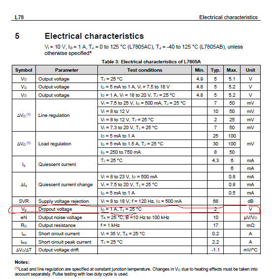

You have a much more serious problem. Look at the attached snippet from the L7805 data sheet. Look at what I circled. Do you know what it means?
The datasheet for a 7805 shows that its minimum input is 7.0V and a 0.33uF capacitor must be mounted at its input and ground pins and a 0.1uF capacitor must be mounted at its output and ground pins. Why did you feed it only 6V?
It means I can't expect 5V but that's ok. I measured with a voltmeter an output of roughly 4.2V and the circuit runs fine, simply because all parts connected to it are not fussy with the voltage. I'd be in serious trouble if I used old-fashioned 7400 series chips like the 74xx or 74LSxx series.
Its minimum input is 7.0V and a 0.33uF capacitor must be mounted at its input and ground pins and a 0.1uF capacitor must be mounted at its output and ground pins. Why did you feed it only 6V?

The 7805 regulator with a 6V input does nothing and does not regulate anything. It might reduce the voltage a little like a couple of series diodes (6V in, 4.8V out). A voltage regulator with the input always above its minimum recommended input voltage is an excellent ripple eliminator, much better than a simple capacitor. Maybe you did not have a large filter capacitor at the output of the bridge rectifier so then the voltage regulator dropped out (stopped regulating) on each half cycle from the rectifier? No, with your 6V input the 5V regulator did not regulate the voltage.
