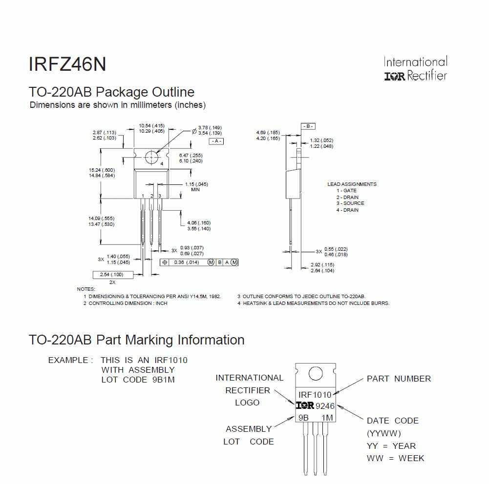

I just type TO-220AB on eBay and it's says Vishay Schottky Diode V20120SG TO-220AB 20A/120V while the IRFZ46N is a Single N-Channel HEXFET Power MOSFET... ? I'm more confuse now (like i always am...)

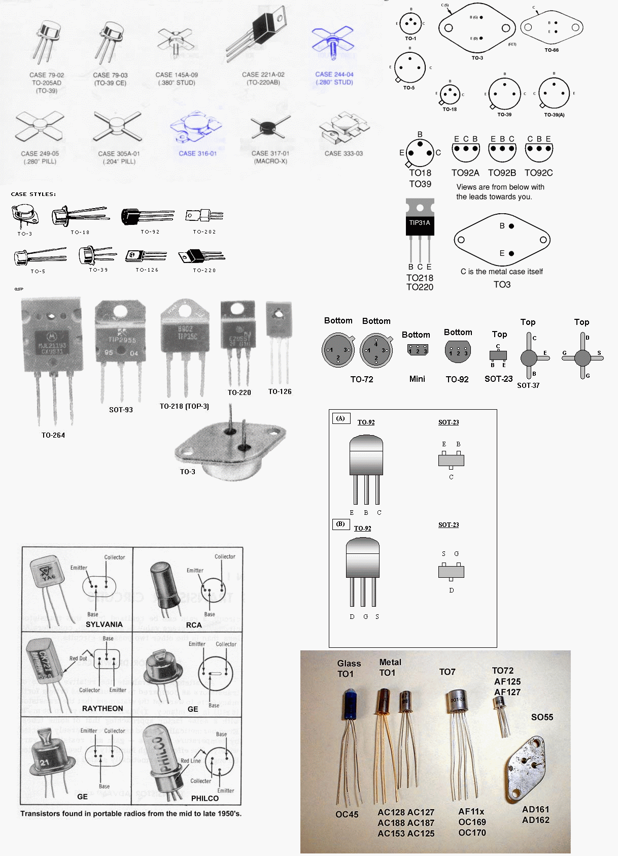

As has already been explained, TO-220AB is just the package type, nothing to do with what's inside the package.
The case style and part number both apply.
Many parts use the same case style but are not the same part.
You can have a part number that is in a different case style as well.
Here is the page from your datasheet.
