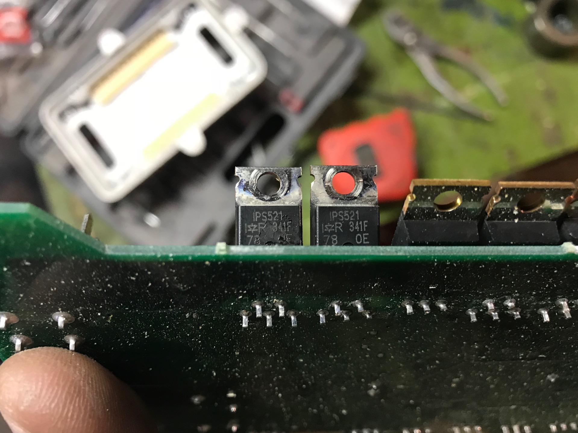

Hey guys, kinda new to electronics. I'm working on a board for a friend and need to replace two ips521 drivers. Those are "obsolete" apparently so i need to find a suitable replacement. I will attach a photo of the original part numbers. Thanks so much for any help! If you have a specific link to the item i need, such as on ebay or an online store...that would be great!

So, would this one be an appropriate replacement even though a few numbers are different? Forgive my ignorance, just wanna be sure before i order.
The date code will be different. The IPS 521 is the most important part. The datasheet doesn’t say there are multiple variants. You should be fine if this part is really the issue on your board.
