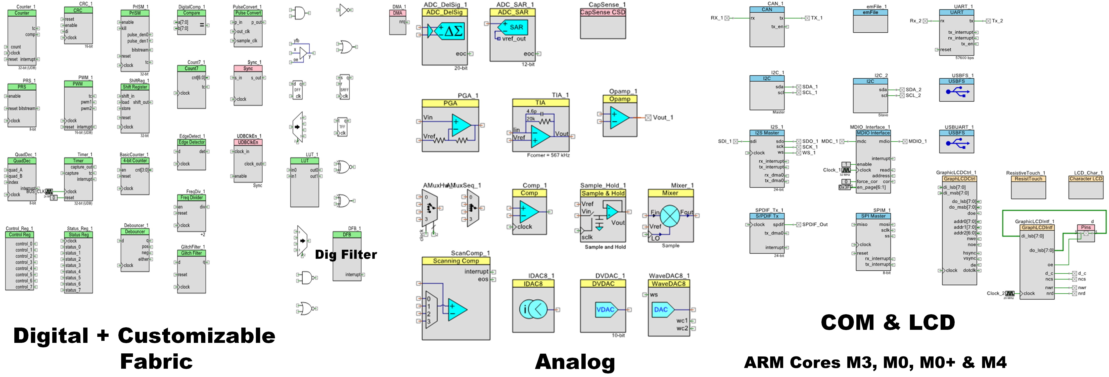

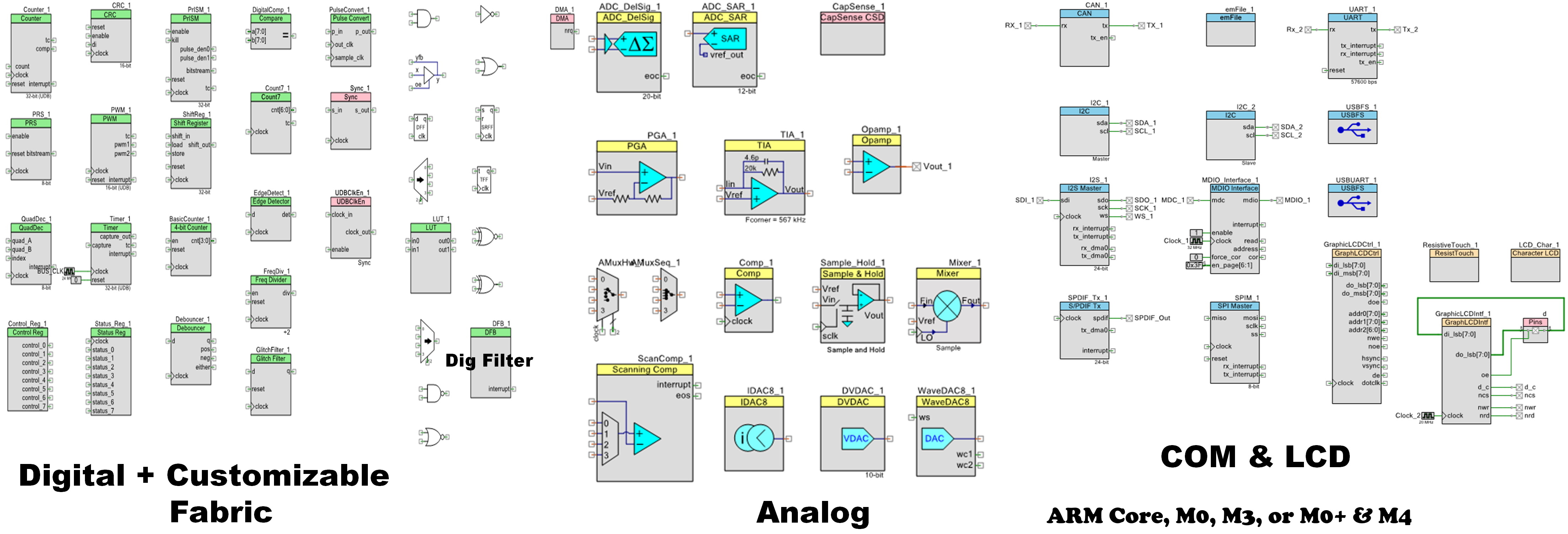

One can use a 2 chip solution, the ESP8266 or ESP32 to do the server, and a
better chip to do the analog. Here is an example of whats on a PSOC that would
allow you expanded I/O as well as robust data acquisition, including filtering if
you needed it. One chip, in below multiple copies of many of the resources
shown. Drag and drop tool, rich API library to manage, and routability onchip.
Like having a proto board with a bucket of parts and wires, all in one chip.
Then hand off to the ESP part to handle web server portion.

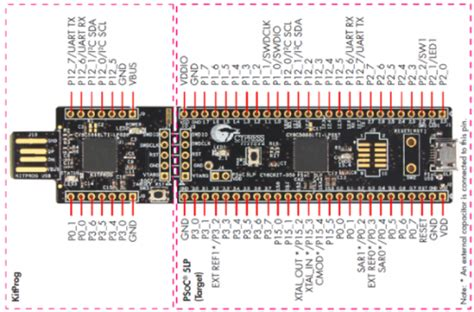

This has the capability in many designs of being a single chip solution -
Above is a catalog of whats onchip. Many multiple copies. Its routable, has a rich API library to
manage each of the components (in PSOC land a component is an onchip resource).
$15 board excellent buy and utility.
IDE (PSOC Creator) and Compiler free.
100's of example projects, ability to create custom components via schematic capture and/or use of Verilog.
With onboard configurable muxes trivial to have 8 analog channels as well as differential, mated
with SAR or 20 bit DelSig. Also onboard precision Vref.
Regards, Dana.
