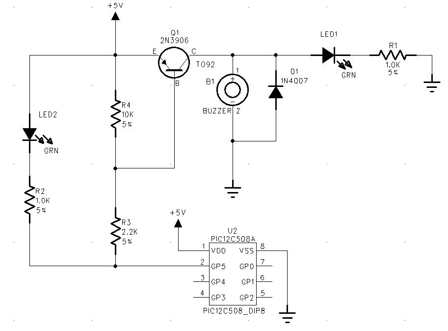

I'm an AVR man myself, but I can help you somewhat, although, I really don't like pics. I don't have any pic development tools so I can't use the .rar file that I am assuming is your code. If you have an ascii listing, or generate one when you next compile, I can look through that. I can help you with your hardware.
1) I don't see any base resisitors on your transistor drives. 220 ohm - 1K.

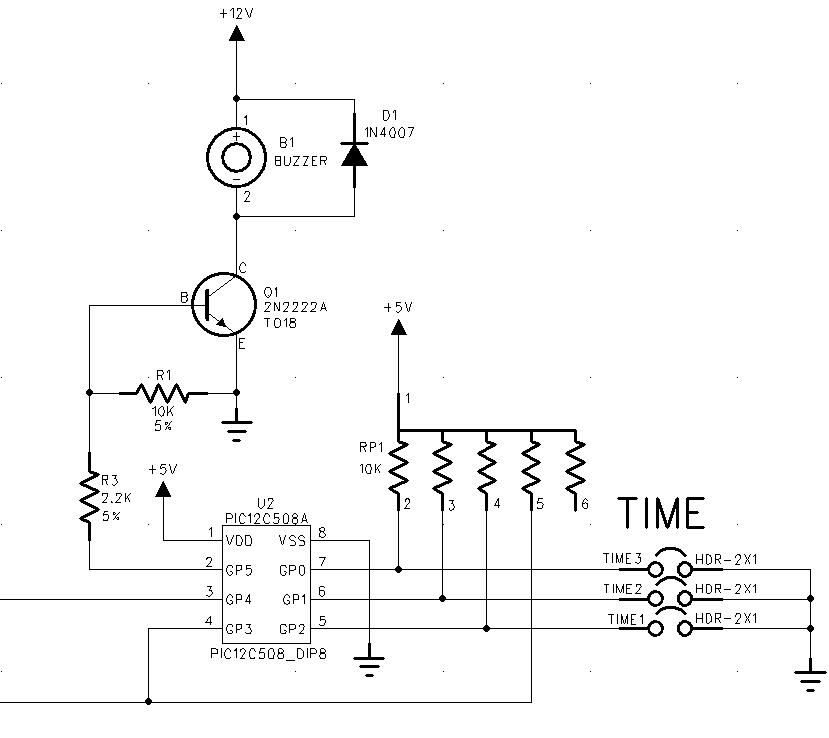

2) what type of buzzer are you using? Is it 5v? Can it work on 20-40mA (probably not)? You should have a transistor driver on that just the same as you have on your LEDs. Some piezo buzzers have a built in oscillator, some don't. Those you have to turn on at off at their resonant frequency, probably somewhere around 2KHz.
3) R28, 29, and 31 are probably not needed... what are they used for? Looks like to pull up the 'node' when the transistors turn off.
Thank you for the reply sir! i should put resistors on the 'base' pin of the transistor..is that correct sir? Im using a peizo buzzer 5v sir.. How can i get an ascii file in the assembly sir?

what part number is your piezo? 12V piezos draw a good chunk of current, 5V would draw more for the same dB output (sound level)... here's how I drive mine... just replace the +12V with +5V. It should drive the buzzer ok, but you may need a low on resistance FET. This is a cheap piezo so it has to be turned on and off at it's resonance frequency, 2KHz...

I've modified the schematic for the piezo to use the same transistor as you already have on the board. One thing we do when we design for assembly is to reduce the part type count, fewer types of parts stocked, fewer types of parts loaded onto the inserter, less chance of getting the wrong part installed... easier to check the final assy... etc...
You can use LED1/R1 OR LED2/R2 for your alarm status LED. I prefer LED1/R1 to take the loading off the micro.
One quick note, your schematic and my first schematic gave alarm output on a high, this will change that to alarm on a low.
