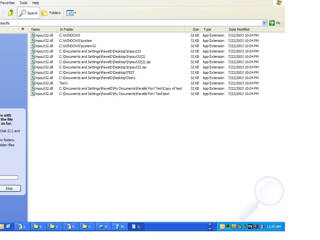

maybe I dont have administrative rights to install it.
Have you found the dll on your hard drive??
If not, Google for inpout32.dll, its available from a number of sites, its free.
Download it, then using Windows Explorer, move it into the Windows/System32 directory.
Let me know how it goes
Why do you think you dont have 'administrative rights ' is it your PC??
Eric
I know sometimes that when I do change the bit status, to like 4 instead of previous after toggleing the switch, sometimes it doesnt refersh or see it to when the switch is back to normal possible. Wondwer if there is something wrong with dll or linking or xp or LPT1 settings.
=/ it is there.

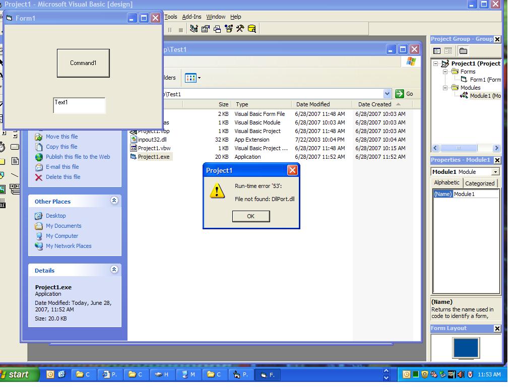

pablome said:
at run time for .EXE I get this.
Google for dllport.dll, download it and place it in your Windows/System directory.
EDIT:
Dll's in zip file.
The zip file you provide has the files to put into directory?
Did google and it says dlportio.dll to search instead?
I FINALY GOT IT TO WORK FINE! :) Those 2 DLL files were surely needed.
Thanks so much...I'll continue on this and see what else is needed.
