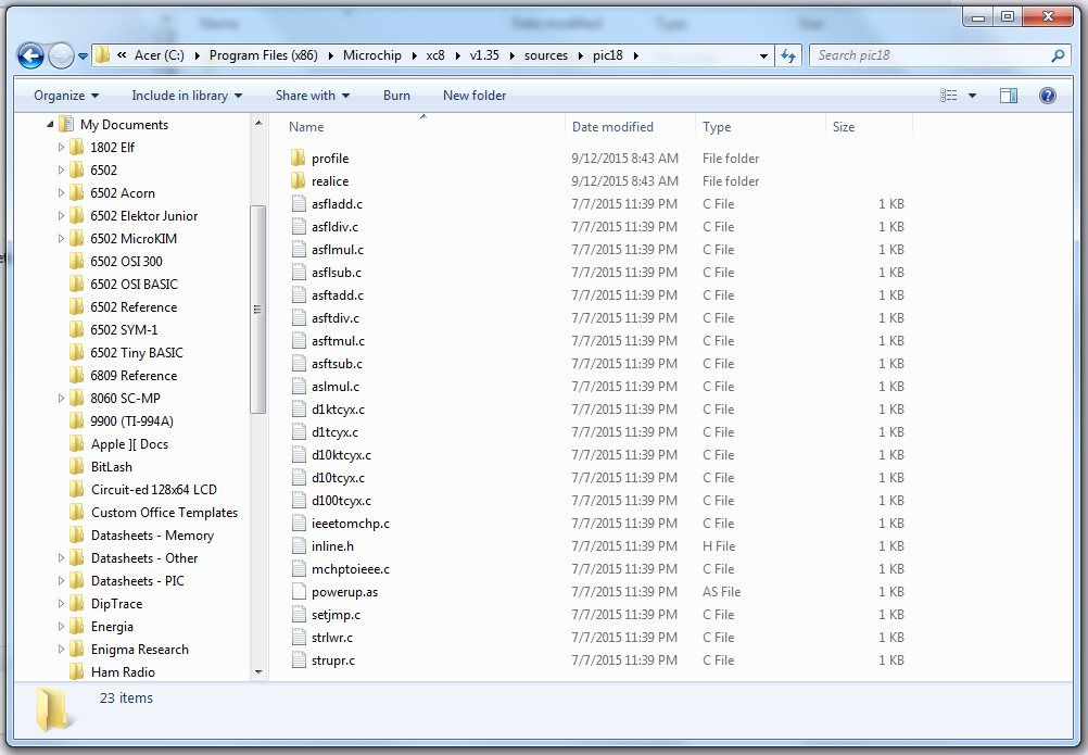

Hi Paul,
You need to control the LCD 'E' and 'RS' lines. Is that described in the PLIB XLCD documentation?
BTW, where would I find PLIB for XC8 and its documentation (I'm coming up blank)?
Regards, Mike
--< added >-----
Found this file which includes LCD connections on the Microchip website; Library for External LCD module (for C Language)

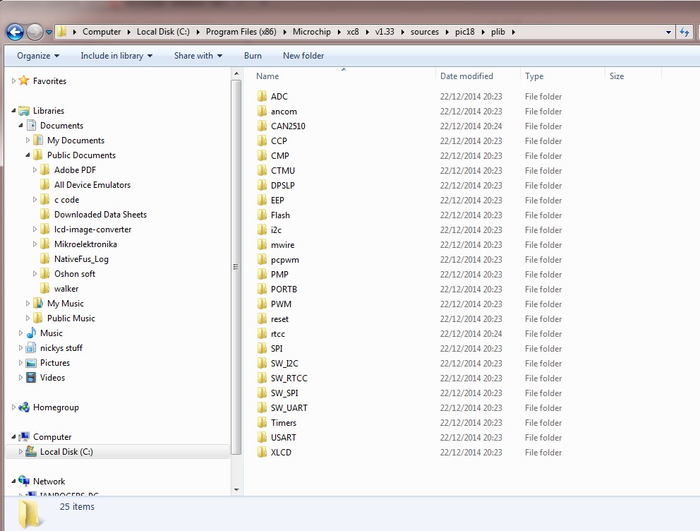

Thanks Ian, but all the header files are missing...
Never used the libraries before. Always used my own low level code.
What did they replace the libraries with? One of the peripheral configuration applications?
Just goes in your include folder
No Idea... I, like you, write all my own libraries...
Funny... I bought MikroC pic32 because the libraries were all done.... I have ended up porting all my own libraries to MikcroC....
Still cheaper in the long run..
