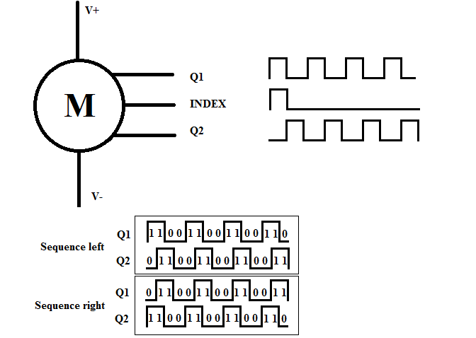

As I'm sure it's obvious from the code the program is supposed to start, "DC Motor driver" will be displayed on the LCD then as I push a button to choose a rotational direction the converted value of the RPM should be displayed on the LCD. But a weird thing happens(as you can see from the photo of the schematic that I've provided). The value displayed on the LCD is too high and it's also not changing(not even when the motor is stopped and it should be 0). I'm guessing it's a code issue but can't figure it out. Please help me correct it. Thank you!
As I explained in your other post!!! That isn't how the encoder motor is connected!! There are two motor models with 3 wire outputs.... One is a servo control and the other is an encoding output!! The encoder has to be interfaced to a quadrature encoder... The servo motor model accepts a pulse width.. it doesn't produce one..
I'm no programmer, but it looks to me that port B is enabled for analog input, but a motor tacho is connected to A0. Is that right?
Hello. Can you please explain how am I supposed to connect it in my schematic. I don't quite understand how am I supposed to connect it. I'm no expert as I said. I'm going to do some research on encoders now.
Correct me if I'm wrong but doesn't a rotary encoder present a digital output rather than an analog one?
Yes I suppose it's digital since it should give a value for speed. So in that case I just have to get it from it's output and display it on the LCD somehow. But I'm not sure if it's digital or continous.
There are encoders that do what you want but that encoder is a raw signal
To use quad encoding study the signal..
However!!! You only need a single pulse... So hook the Index pin or the Q1 pin up to the "INT0" pin and count the input for 1 second That way you can determine speed..
Get the interrupt to fire every 250mS and work out the pulses... say you count 1 pulse then the motor is at 4 hz on the index pin or divide the PPR into it if you use the Q1 pin..

To the OP - what I was getting at was that the output of the encoder is digital, hence you don't need to use the ADC. Follow Ian's guidance above.
If you were using a potentiometer, then you would use the ADC. But not with an encoder.

Hello again, thanks for the answer.
Here's what I added to the code:
         PSA = 0; // to set preescaler to Timer0 module
         T0CS = 1; // to select counter mode
         T0SE = 0; // to select rising edge as incrementing edge
         __delay_ms(50);
         __delay_ms(50);
         __delay_ms(50);
         __delay_ms(50);
         __delay_ms(50);
Now I suppose I have to read the TMRo to get the value but I don't know how to do that. Specifically what bit of the TMR0 I have to read and how do I do that. I just create a variable, store the value of the TMRo in it then convert it to a string so I can display it on the LCD? Is that the way?
Excuse my questions which may seem dumb to you but I'm no expert like you guys :). Thanks.
