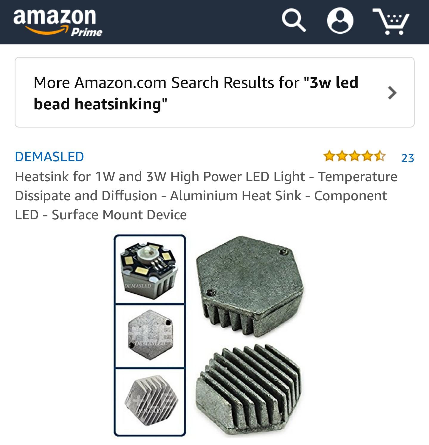

Why do 3w LEDS have a high risk of failing?
The only reason I know they fail is when they get too hot. And why do they get too hot? Improper heat sinking.
As the "expert" in your dealings with the original poster, isn't it your duty to understand what heatsinking is required and to advise him of this??? Proper heatsinking isn't a mystery. If you can't provide proper heatsinking for a 3w LED and you expect it to be a problem ("there's a high risk of fsilure."), why not cut back to a one watt LED in the same package?
