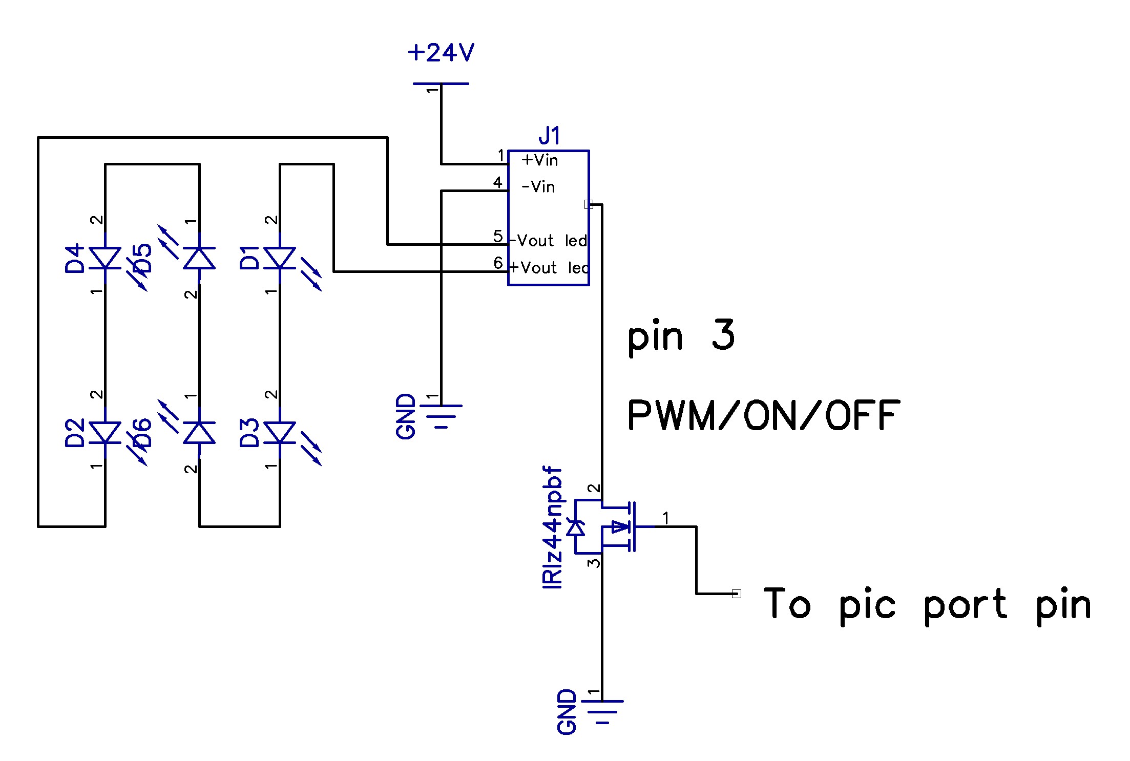

The data sheet shows a pin on the module for ON/OFF so I am thinking of using the mosfets or similar to control the leds via a pic. the mosfets circuit I have uses logic level so it just might work(see attached for my original schematic). I tried contacting company to see what current draw the PWM/ ON/OFF pin # 3 requires but have to wait until Monday to get more info

Here is what I am considering depending on module requirements on pin 3 (PWM/ON/OFF

The on/off pin is designed to have a micro drive it directly. I don't think there will be a problem. Remove the MOSFET. It only pulls down. You need to pull up to above 2.5V or down below 0.4V

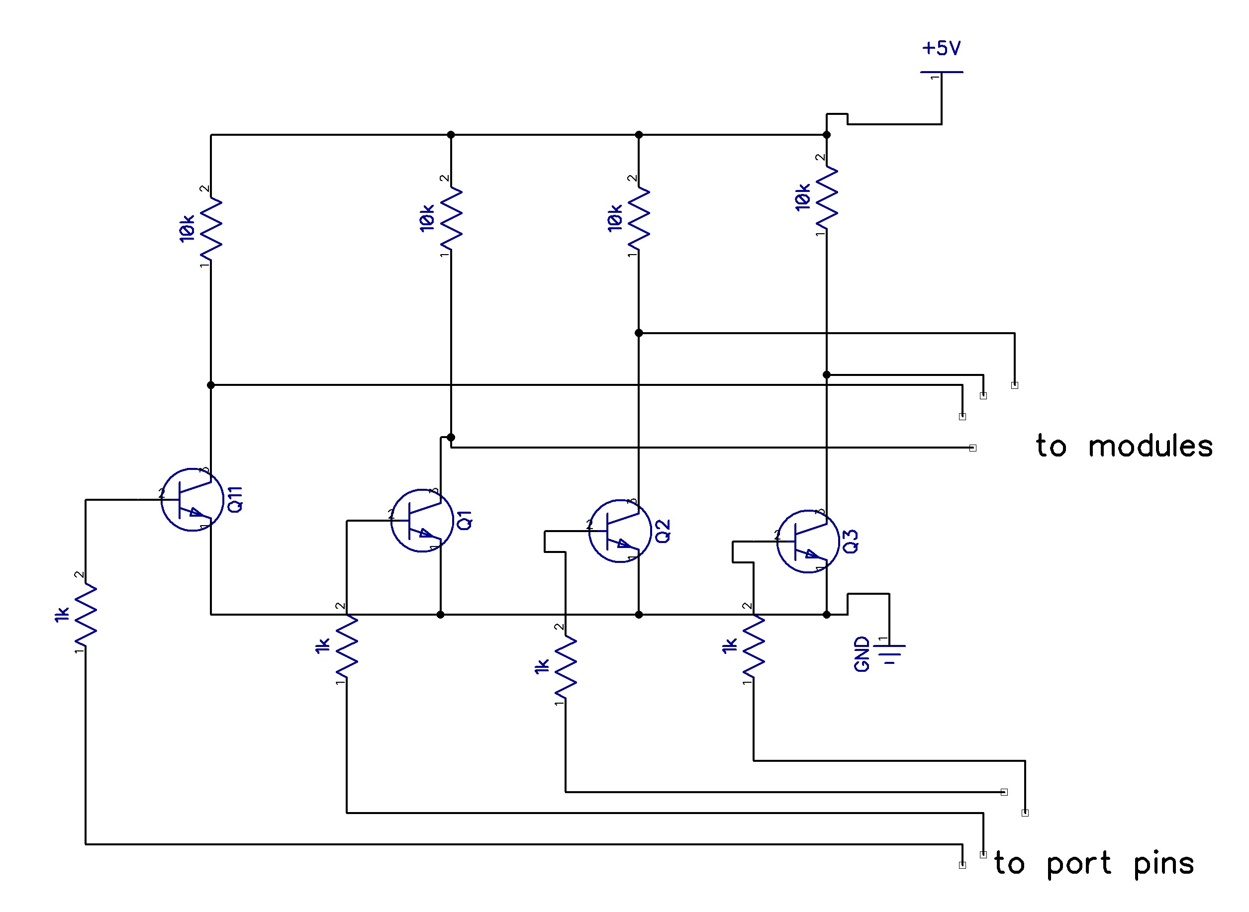

looking over the data sheet and yes ron is correct as per data sheet that it appears the mosfets and related componets are not required but to play it safe I am emitting the mosfets and resistors and using ether a simple 2n2222 transistor or ??
the data sheet shows for control of the ON/OFF/PWM pin it requires
H>2.6-5.5vdc or open circuit
L<.4vdc or short
this is for the 1000-1500ma module

As for controlling the modules, I want some isolation between the pic port pins and the modules so looking at a 2n3904 transistor.
This will isolate the pic from the module and guarantee that the PWM/ON/OFF pin is either HIGH or LOW. May no be necessary but IMO a better mouse trap. Better safe than sorry. To play it safe, I plan to call the supplier on Monday to double check etc.
will post a schematic.

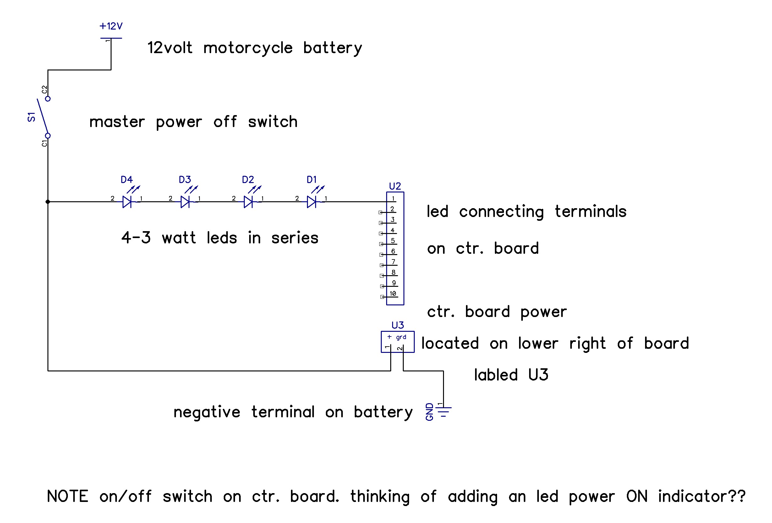

Little more math here then meets the the eye 4 leds is 12volts as posted i sim this for mrdeb it was funny but it shows a 1 amp drop which i would think 4 leds 4 amps but to ground its one amp from the leds and each led burns off a amp in heat i guess .
I was using 4 to test you use 4 amps from the supply and sink one amp at gnd.
There's a lot of heat
band-schematic-jpg.105638

Heat comes form watts, which is Volts X Amps. 3 watts = 3 volts X 1 Amp
Motorcycle battery; voltage is 12V when the power is off. voltage = 14.5V (more or less) when the motor is on. I know that is picky but the current will be much more than 1A at 14.5 Volts. And much less at 11V. (using real LEDs and real batteries)
"it shows a 1 amp drop" "4 amps from the supply and sink one amp at gnd"
Current is much like flow of water. 1A comes from the supply and passes through D4, then D3, D2, D1 then into ground. The same 1A in all spots. (some people see current as negatives so current flows up or backwards)
Normally "12V" of LEDs should not be placed across a 12V source. LEDs need a resistor or some device to limit the current.
