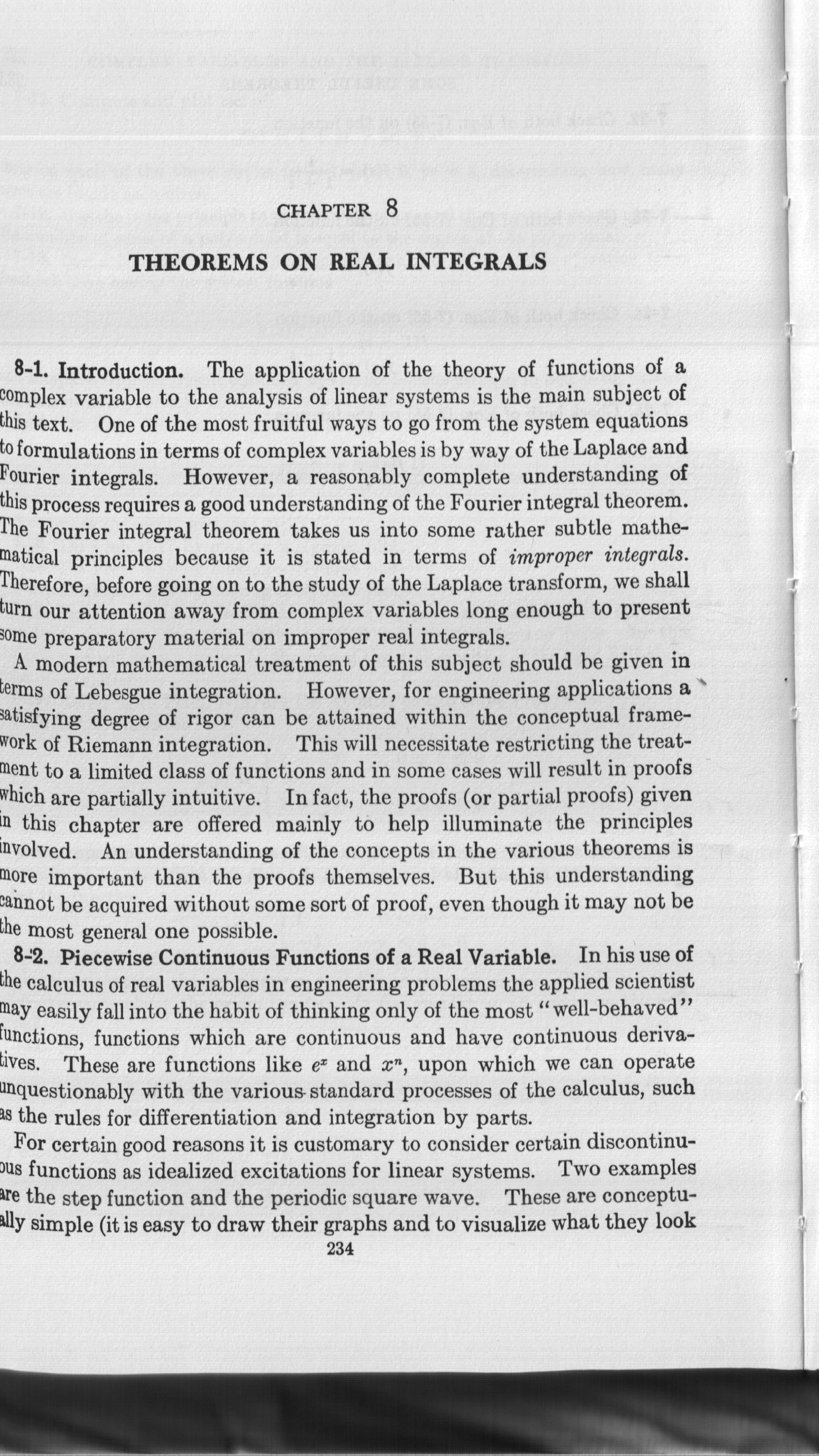

I've attached extracts from two different books. The first two pages are from "Complex Variables and the Laplace Transform for Engineers", by Wilbur R. LePage (I highly recommend this book BTW). And, the third page is from "Calculus of Variations", by Robert Weinstock. I have other books that conform to this definition also, but this is the definition I've always seen and used.
To me the term "continuous" automatically includes our normal well behaved functions, but also includes functions with kinks (first derivative has jump discontinuities). However, it does not include jump discontinuities. This is the reason for the term "Piecewise Continuous". It allows a class of functions that are continuous in a finite number of regions, with jumps at the boundaries. This becomes important for evaluating Laplace transforms of many discontinuous function we deal with in EE and physics.
In the absence of a direct quote from PGs book, I would recommend using this usual definition because, to the best of my knowledge, it is the definition used by mathematicians generally.

Hello again,
Yes that makes sense, but how it is used in a given purpose i think is just adding a bias (note the first reference uses Dirichlet as well, which seems to imply that they are seeking results that are not necessarily coming from pure math).
But the second reference is interesting in that it appears to come from a math book on Calculus. They clearly state that it is ok to call a function a piecewise continuous function if it has finite jumps as long as the two limits of the joints are both finite. That does make sense too.
I think this definition might be more intuitive also.
They only question at least for me then is how do they expect to integrate a function using a single value of delta x over an interval that may not even include a given point. But perhaps i am being a little too nit picky here.
But yes now i have to agree that without any further definition from PG's actual texts that your stated definition is the better one :)
I don't think this is too nit picky from a mathematicians point of view. I think physicists/engineers intuitively have no problem with this since, in the limit, the delta x gets infinitesimally small. Also, intuitively, we can just break down the integral into a summation of integrals over the continuous sections, which results in different delta x for each region. But, these are examples of the kinds of thinking that make the mathematicians throw spears at us.

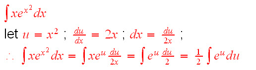

Hi
Re: Post #11
steveB said:
If you leave it inside the integral and then realize that x=sqrt(u-1), you would have a new integral to solve.
I just did it and found that the relation x=sqrt(u-1) isn't correct, at least as far as I can confirm it.
steve_post121-jpg.70548
Kindly let me know if I still have it wrong or you just made a slip. And I'm sorry for asking you this now even though that problem is months old. Thanks a lot.
For my own reference:
This is what MrAl was saying in the post #6.
Regards
PG
It looks like what you wrote is correct, and it seems i made a slip of the pen. If you define u=2(x^2+1), then x=±sqrt(u/2-1). I believe that I was writing u=(x^2+1) when I sketched it out myself, and then I somehow applied my choice into your discussion.
