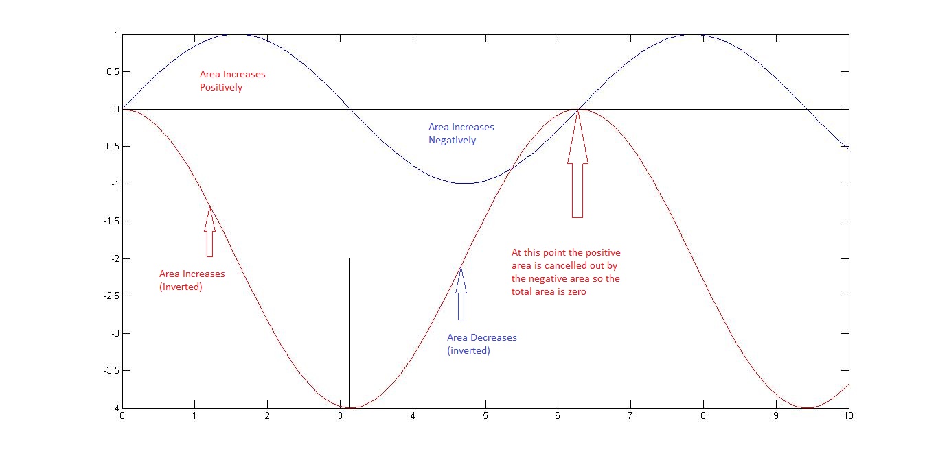

actually the dc offset can be explained logically.. since the integrator is supposed to integrate that means the area is added up. And in the case of a sine wave with an initial value of 0 the area is added and subtracted throughout the curve in the positive and negative sections and therefore the area never becomes negative..
heres the image explaining this.. the output signal is on the negative side because the output is inverted..
so logically there must be an offset..
so the problem is it not showing up in the calculations :)

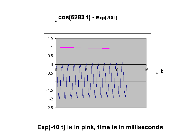

So I did a calculation using Excel and the attachement is the result.
It shows the first few cycles of the cos & exp terms.
My version of MrAl's maths is:-
Vo = (R/r) * {-sin(ωt) + ωτ[cos(ωt) - ε ^ -t/τ]}/[(ωτ)^2 + 1]
where τ = RC So it is the negative of the previous.
Again, the sin term can be ignored since ωτ is >> 1.
However, there is no offset.
The cos term is shifted downwards by the expontial.
Thus, at t = 0, Vo = 0 and the curve goes down from there since the exp term is still close to 1 (large time constant) thus the curve is approx cos - 1.

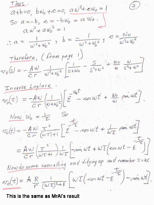

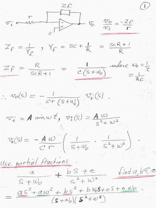

normad wanted to see the Laplace solution so I've attached it.
Contrary to my earlier post, it is not necessary to reverse the I1 & I2 currents. It is easiler to use Kirchoff's current law, ie. I1 + I2 + I3 = 0 and then the correct sign falls out.
