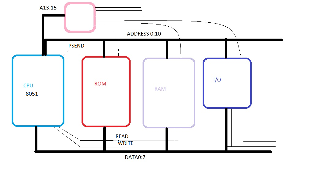

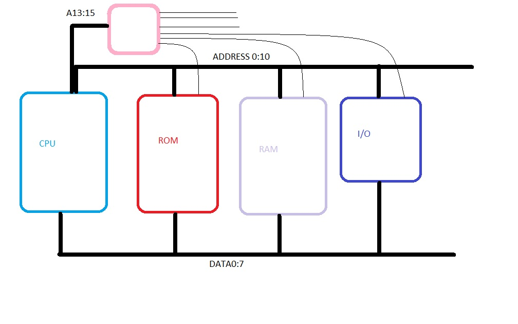

Here is one way. ROM has a address. RAM has a different address. Input / output had a third address. You (in this example) can not have ROM and RAM and I/O at the same 8000 address.
Here is a 8051 example.
There is a wire called PSEND that turns on the ROM and is used only to get a instruction.
There are wires READ and WRITE that talk to RAM and I/O. They are used for data and not instructions.
In this case you can have a instruction at 8000 and data at 8000 because they are really not at the same location.
Program 8000 is not the same as Data 8000. The address bus is 8000. But PSEND or READ determines which memory is turned on.
In the 8051 world we some times OR together the PSEN and READ lines together so the data memory and program memory are the same.

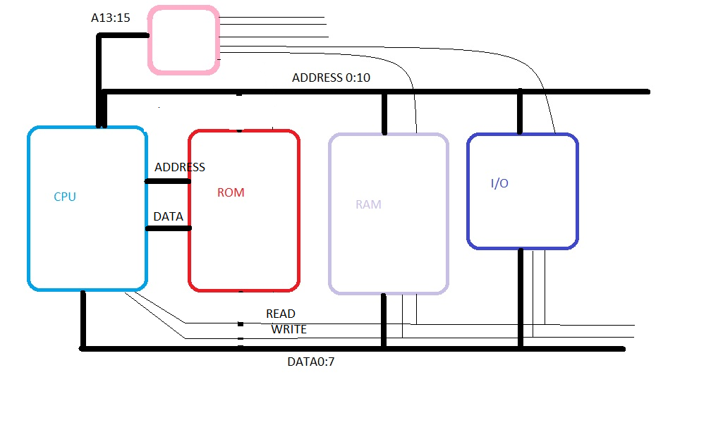

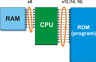

Here is a third type of computer. The ROM address and RAM address are different wires. The ROM data and the RAM data is different wires. Usually the I/O share with RAM. The I/O can be different.
In this case the data and instructions can be a different size. (8 bit data and 12 bit instructions) There is nothing in common with RAM and ROM. It is likely that a instruction and data are happening at the same time.
