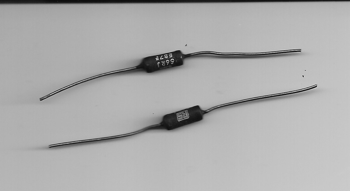

Simple observation tells you the power rating, they are standard 2.5W resistors - here's a scan of a couple I've just taken out of a draw :D
