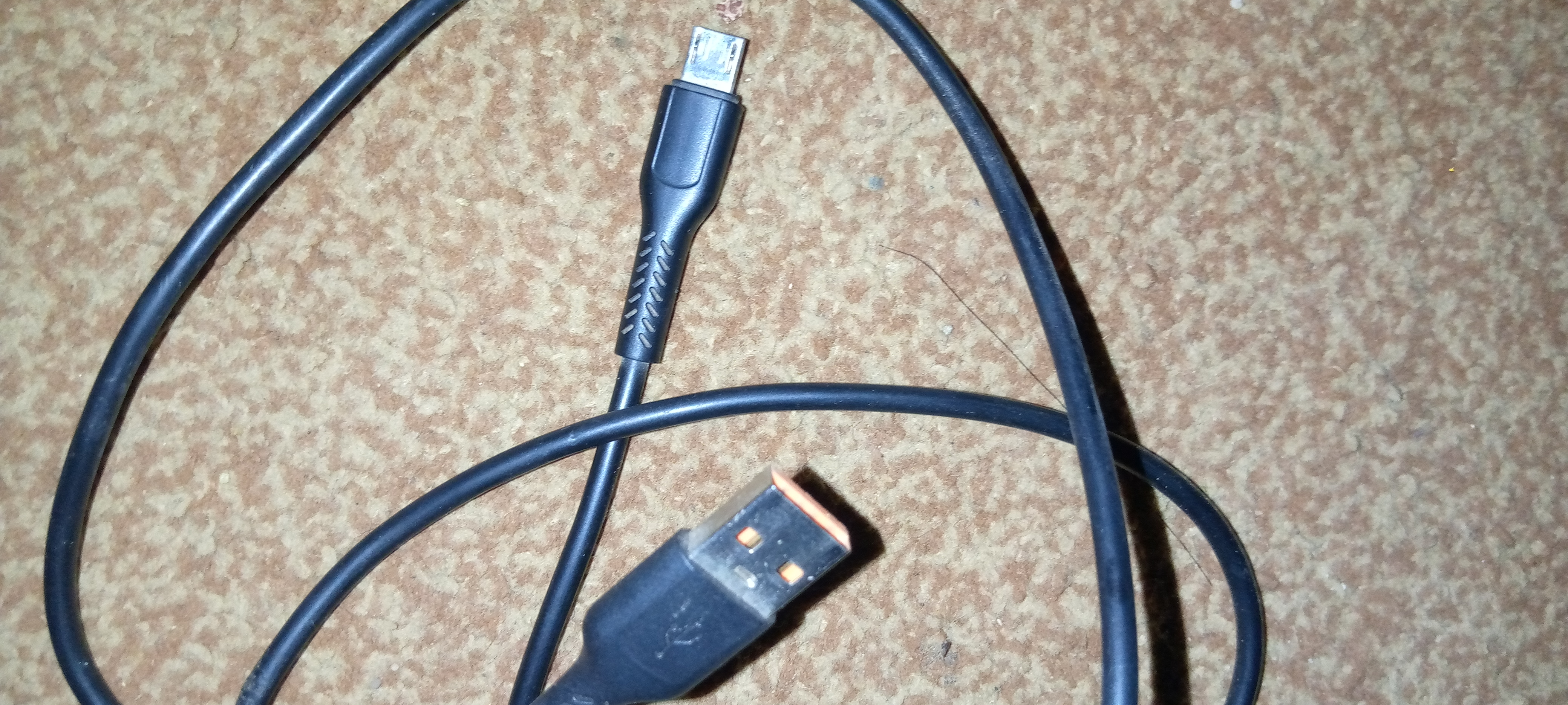

Please how can I rectify this? The USB terminal have developed fault so I cut it out.
You need to provide more information, what it is supposed to do & connect to?
It's obviously a gadget with photovoltaic cells, but other than that ????
It is to be connected to this USB wire to charge a phone, I was using it to charge my phone before it developed fault and refused to charge anymore, that was why I decided to cut the head terminal
OK, your first image shows a Red and Black wire, two wires off the solar panel. A Google of "USB Pinout" will bring up a few dozen images. Your cable shows a USB A (Large) and USB mini or micro which likely is where it connects to your phone. Note the connector pinout and where the power pins are (the outermost) on a standard USB A connector. If you cut off the connector end which connected to your panel note the pins. The cable may even use the same red and black color scheme. You are only using two of the four wires.
Ron
Exactly most of the USB outlet I saw on Google are having four pins, and my solar panel wire is just two red and black. So I can connect my solar panel wire which is two red and black to the four pin USB outlet?
Yes, I covered that. USB 2.0 consist of four lines, two are power and two are data. You have no need for the data lines leaving two power lines. I gave you what to Google for your connector. Let's not make this complicated.
Ron
You're welcome and best of luck.
Ron
