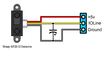

have used 3 types of the Sharp GP2 sensors with no real stability problems but I had a good +5v supply and short wiring. Lots of people do report erratic readings, (probably noise?). Putting a 10uF cap right at the sensor power between +5v and ground is supposed to help, and also doing some low pass filtering of the analog voltage out would help especially if you have long wires between the sensor and the PIC.
the attached pic shows put a cap from the i/o line to ground.....
would it really make a difference in my readings that i placed the cap right at the sensor power between +5v and ground .....and not as shown in the pic???
The caps on the wrong pins.!!:rolleyes:
Should be +V and 0V common
