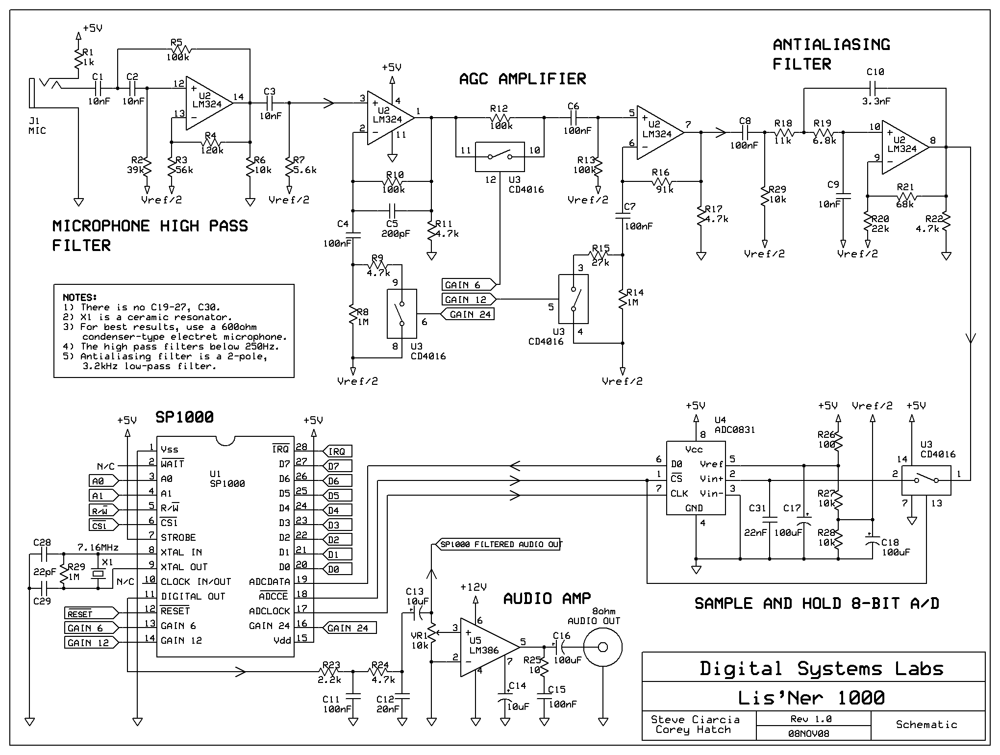

I'm looking for any information I can get on this chip. I've got a few pieces I purchased back in the early 90's from ACP (remember them?). I never got around to doing anything with the chips because I couldn't find a datasheet for it. I seem to have more time on my hands these days, so I thought I would try to *finally* get this project started up. Alas, still no datasheet to be found anywhere that I've looked. After a search, I was able to find mention of the Nov. 84 Byte article. Of course, I have no Byte mags handy now....
So, to summarize, a sample circuit would be a good start for me. Ideally, I'd have a sample circuit for the voice recognition hookup and speech synthesis hookup. Apparently, the chip is capable of both which makes it that much more cool.
Thanks guys.
Like I said, I have the article but no scanner. What are you looking for?
So, to summarize, a sample circuit would be a good start for me. Ideally, I'd have a sample circuit for the voice recognition hookup...
Okay, here you go, I drew it up for you. The microphone low pass filter cuts out everything below 250Hz; the AGC monitors and adjusts the incoming signal amplitude so it always stays within the range of the ADC (it can adjust the gain from 0 to 42dB, in 6dB steps); the antialiasing filter cuts out all the high frequency clickity-clack from the analog switches; and the ADC converts the resulting audio to an 8bit serial data stream. The remaining logic inputs are for you to decide how best to address (from a micro or equiv.), and software, well, that's altogether something else! I don't know where you're going to find that.
Also, regarding speech synthesis, the Lis'Ner 1000 used an SSI-263 phonetic speech chip in conjunction with the circuit below. I have not added it as it requires that particular chip:
Corey,
Awesome! Thank you very much for this. It's just what I was looking for.
Wasn't the SSI-263 the same as the SC-02? If so, I've got a couple of them handy.
Thanks again.

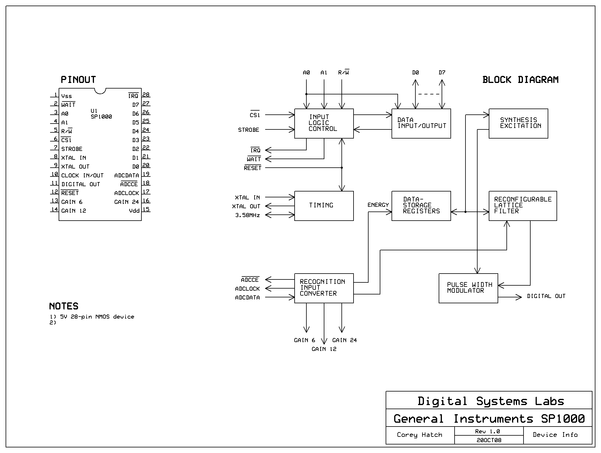

First, I presume you noticed the two drawings I've already posted. Second, there are no coding examples given in the article. They expect a person to use the advertised development kit (software by Steve Ciacia, Byte, and/or GI; it's not clear who wrote it, only that it was available).
The article provides two flow charts in getting the deed done. If sufficient interest exists, I can reproduce those in the manner I've used before. They show a general procedure, but nothing is given regarding internal register structure, etc. Someone would have to get their hands on the SP1000 programming model before the flow charts would be useful at all. As the chip is a memory-mapped peripheral, obviously there's a lot there one is supposed to be able to access.
The BASIC routines they used implement a discrete-utterance, speaker-dependent model of two major blocks: a training mode and a recognition mode.
