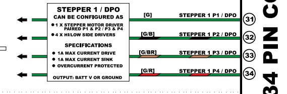

I have an aftermarket car ecu that has a 4 wire stepper motor attached to it.
Unfortunately, the ecu is current limiting to 1 amp.
The motor needs 1.85 amps (6.5 ohm motor, 12volts) :(
It therefore needs a bigger current supply (no position feedback needed).
It has been suggested that mosfets or BJT transistors be used.
Is there anything I can build or get pre-made that would suit to drive this motor to what the ecu is commanding?

So your using the car ECU (ECM?) to control a stepper not the VVT solenoid or EGR motor? If your using the ECM for what it's made for why do you think you need a higher amperage out put?
The ecu is an aftermarket item (Haltech) and can be fitted into many cars. The stepper output they normally use for Vtech solenoid, idle air control motor or a rotary engine oil metering pump.
The throttles are off a completely different vehicle, hence the mismatch between current limit of the ECU, and the current need of the stepper motor attached to the throttle.

Sounds like a power BJT (e.g. 2N3055) used as an emitter-follower should do what you want.
