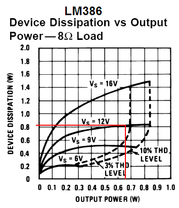

Didn't you try my "smoke test" with a continuous sustain at clipping?
The graph for the voltage output of an LM386 that I posted before shows that it produces 660mW at clipping into an 8 ohm load with a 12V supply. The power dissipation graph I am posting now shows 820mW of heat.
Its spec's show a thermal resistance of 107 degrees per watt so its chip temp with a 25 degrees ambient is 112.7 degrees C. Its max internal temp is 150 degrees C.
YOU ARE RIGHT, it doesn't get too hot in your application! :lol:
EDIT: With a 4 ohm load, your LM386 with a 12V supply will produce only 450mW at clipping, and 1.3W of heat, way off the end of its graph.

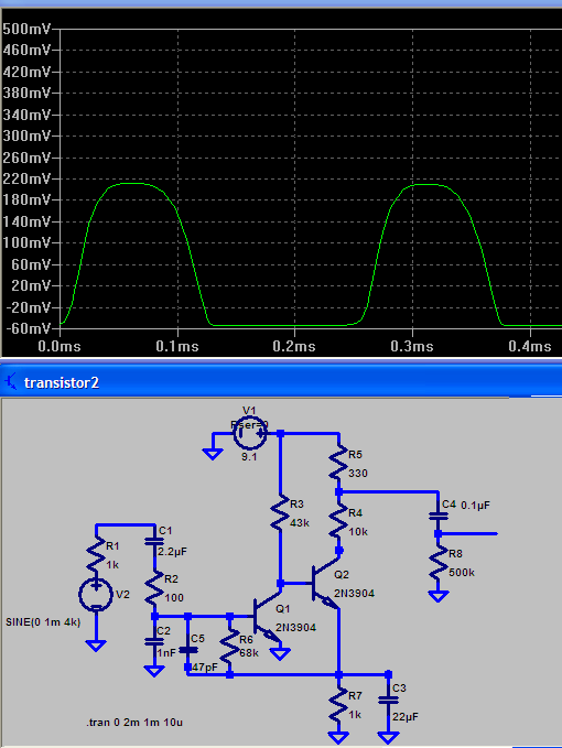

Here is a sim of a Hendricks circuit with a pure sine-wave input:

This is one that I designed myself.
And the first one I built was actually very similar to what you just showed for a fuzz face. Mine used germanium trannys instead of 2n3904s. Along with a couple different resistor values.[/img]
One uses LEDs as diodes, the other uses 1n914s. It sounds *almost* the same using one or the other, but I found that I like it with both.
The LEDs won't do anything with the diodes in parallel with them. Therefore the 1st transistor doesn't do anything.
First off, why don't they do anything?
Second off, someone that built my pedal (I posted the schematic on diystompboxes.com) had said the same thing, but then tried it and noticed a difference when using both trannys.
here is the link:
The LEDs won't do anything with diodes in parallel with them.
The sim looks like an ordinary "soft clipper":

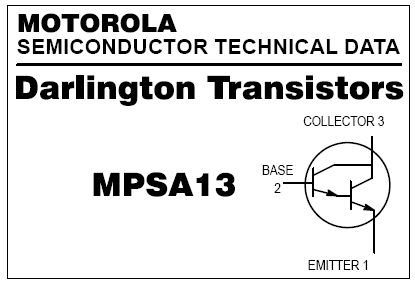

Well, first of all, you changed the schematic.
It uses MPSA13s, which are darlington trannys, unlike 2n3904s.
Also, Q1 doesn't feed into Q2 like you show, both bases are connected to input line only. They are running in parallel.
My simulation software doesn't have a small darlington, so I made one with two 2N3904 transistors. Same thing.
Transistors in parallel work only with the strongest one and the weakest one does nothing. Therefore I used only a single darlington.
An LED needs 1.8V or more to function. The ordinary diodes in parallel with them limits the voltage to 600mV so the LEDs do nothing.
Your circuit has a symmetrical clipped waveform, therefore doesn't produce even harmonics. The Hendricks circuit I posted has an unsymmetrical waveform, therefore produces all harmonics.
