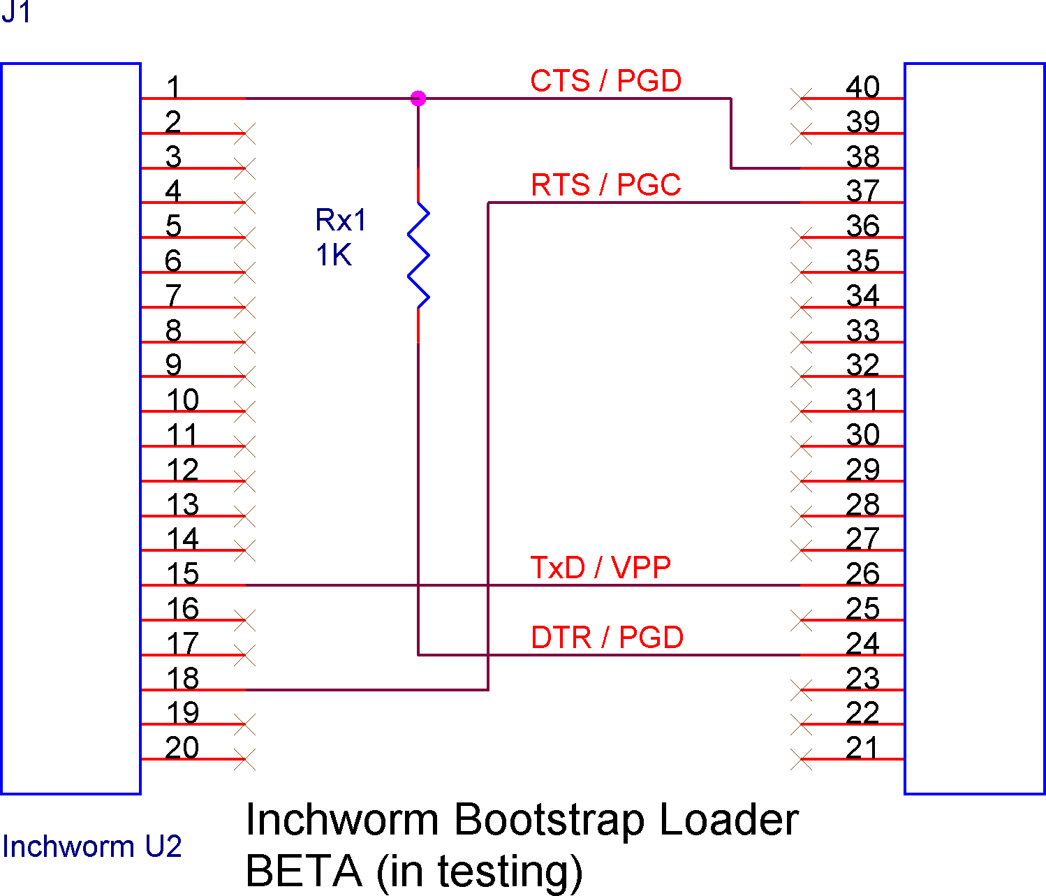

Inchworm ICD2 Bootstrap loader BETA
I've yet to test it. Today is my Birthday and kinda busy ;)
But I've cobbled together a simple schematic to make the Inchworm temporarily a sort of JDR style programmer. It's in TESTING and may not work but I've posted it for your study / amusement / suggestions...
You will need to hook up your blank 16F877(A) to an external programming socket on the ICD connector (CON1). And currently I'm using a 100K pulldown to GND resistor on CON1 pins 1,2 at the target device (MCLR)
It inverts most of the RS232 signals but fortuneately the Pony Prog software allows for inversion of the I/O pins on your COM port. (I'm using the JDR mode).
If I / we can get it working it might be just the thing for those of you whom cannot get their hands on a programmer for the Inchworm (ICD2) Bootstrap BL010101.HEX file.

As to the problem of getting a bootloader into an ICD clone, why not use LVP as outlined on **broken link removed**
Yeah, but once you get the BL installed and the ICD2 up-n-runnin' you simply program another '877A with LVP off and replace that first '877A in the ICD2.

William At MyBlueRoom said:
For some I'm sure getting the bootloader on a chip is the hardest part.
I can see the questions now: "Why do I need a programmer to program my programmer?"
I'm not disputing that. I'm simply saying that if it's easier to program the bootloader into the '877A using the LVP programmer than it really shouldn't matter because you can always burn another '877A with LVP off once you get the ICD2 up-n-running.
