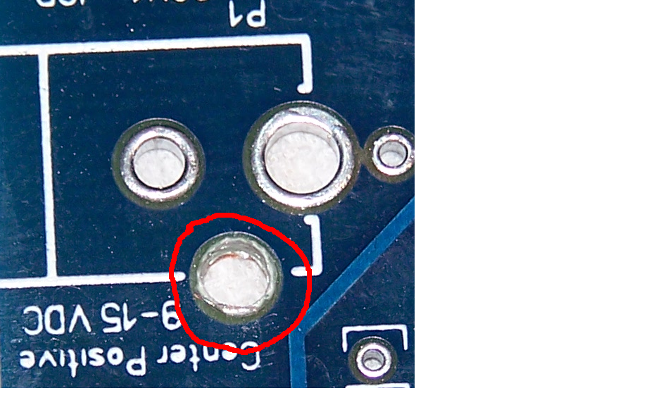

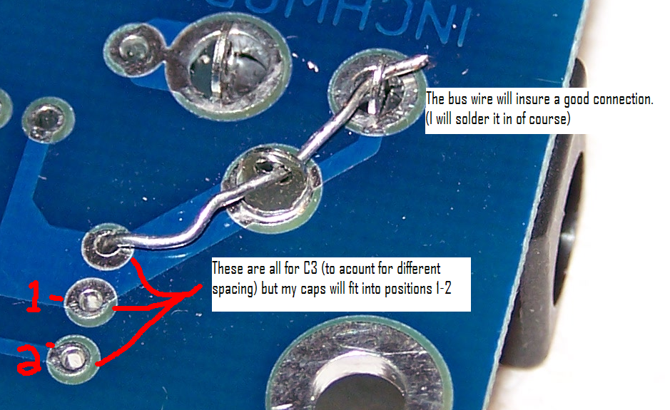

Same thing here(as original poster). Dipmicro supplied a 10V cap instead of a 25V cap for C2. I don't really feel good about the derating so I'm going to put my own 68uF 35V cap in. I guess since it is just to reduce ripple on a 5V line the one it came with will be fine, but I would like it at least as good as the original design (the way it was tested). I will put the same thing in for C9.

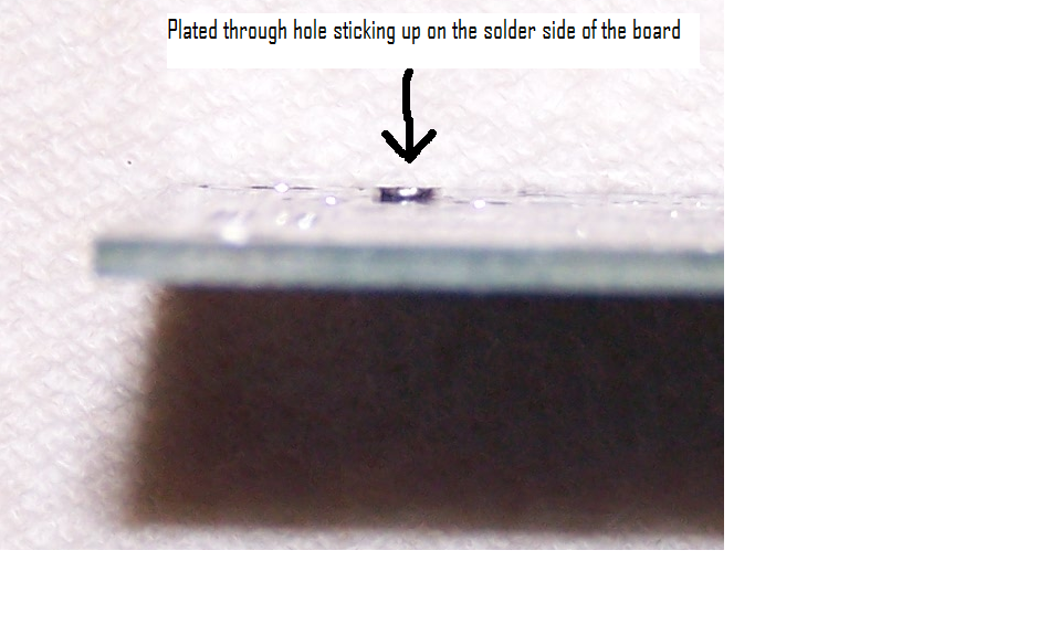

Also one of the plated through holes on P1 did not turn out right.:(
Overall I am still very happy. You can't beat 36$ for this level of programmer. Customer service with Dipmicro is great and the components are high quality. Except for the one minor flaw, the board looks fantastic.

I'm going to supply parts myself for the next batch of Inchworms. I don't mind a couple of part subs for non critical parts but drilling out holes is not something I can reccomend, DIPMicro has modded the PCB that's why the plated hole sticks up. Your wire should solve it nicely but it is something I'll fix (larger holes for P1) so we can use more commonly available power connectors.
