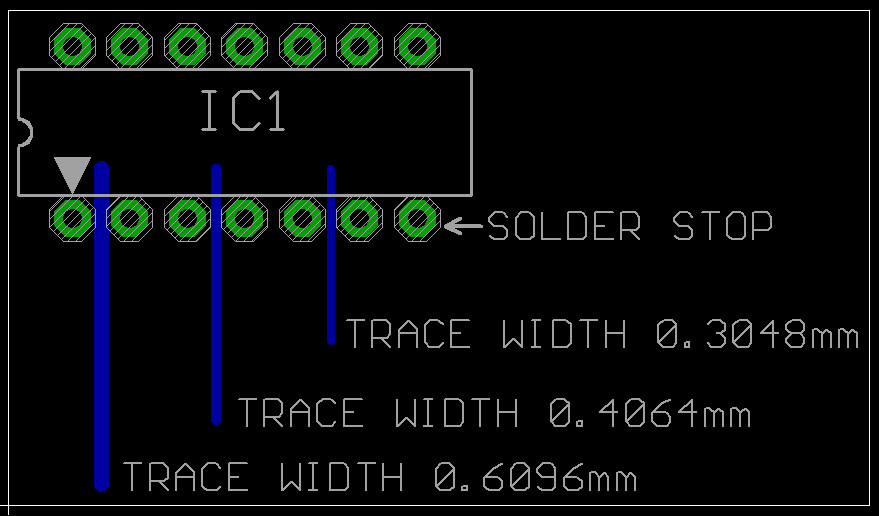

Perform a DRC after the board design is finished. Frequent errors are "distance errors" which can't be fixed during the manufacturing process. Distance errors automatically lead to shorts when soldering parts into place since the solder stop won't cover a trace too thick leading through two adjacent IC pins.
The standard minimum distance is 0.2032mm using Eagle. I always use 0.254mm for extra safety.
Here is a small example using trace widths of 0.6096, 0,4064 and 0.3048mm. The first one is extremely dangerous, although the trace has no connection with the solder pads it's passing. However the solder stop mask leaves a small portion left and right of the trace uncovered calling for a short circuit.
Angle errors have no (or little) effect on a functioning circuit but they will make the PCB design look ugly. 90 degree trace junctions should be modified for twice 45 degree angles in and out. By the time the etchant has cleanly etched the 90 deg angle some traces might have fallen victim to it.
