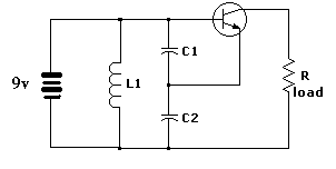

I looked at the colpitt's circuit and ya that's simple enough thank you. To make it work can I do this?
attachment.
No. The inductor is a short across the battery.
The transistor has to be biased correctly and it needs a collector supply.
Do a Google search.

All right, from the circuit that Ron H. has pointed out it is simple enough to understand and learn from this oscillator. This is what I needed to get started. Thank you all for your comments as well.
