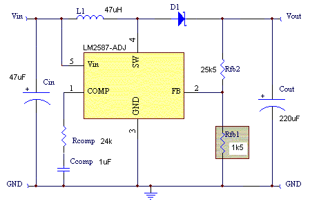

This is a possible solution...
Hi there TheDisturbedOne,
Yes, its that sort of thing.
An inverter (typically)gives a square wave into a transformer
from a battery, and the transformer steps up to mains voltage.
Its ok for lots of stuff, but it can upset some electronic goods.
Maybe they do units now that give better waveforms.
Regards, John :)

I'm sure, no need inverter. If You build the boost converter ( my previous post ) with serial diode and high capacitor on input, it will work.

I can see that the circuit posted by Sebi is not that difficult to build,
the problem is where I live, I don't have any electronics shop to go and buy the components, even the IC ( I think is a National Semicond) this one is not expensive, but like Jaw says, yeah, is faster to get one from Walmart,
