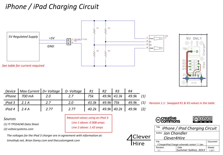

When I charge my phone via a usb charger you plug into the power point, by measuring the output voltage and draw current, it shows around 5.2 volts 1.5 Amps. So the phone is drawing around 1.5 Amps.
When I used a hand cranked charger (portable charger) the output is 5.4 volts with .5 Amps draw current from the phone.
So I tested the portable charger (hand cranked) and it seems that I can get as much as 5.5 volts 3 Amps from it consistently.
From what I'm told, this is because the phone queries the charger and tells it how much draw current there should be. Unfortunately, the phone can't communicate with the hand cranked charger so the draw current remains low at .5 Amps.
I was told to bridge the positive and negative terminals of my charger output cord with a 1000uf to 47000uf capacitor. But I'm not sure what this will do. I can't seem to find the person who told me this so I'm asking does anyone know why this would work and if there are any other solutions to my problem?
Unless your power source has the necessary communications circuit or whatever your particular phone uses to identify a power sources current capacity, just adding capacitors wont do anything.
iPhones determine the maximum current they may draw by voltages on the data lines. Four resistors will tell the phone what current it may draw.

iPhone/iPad Charger Discussion
Android use a different system. I haven't tested this out, but I have read that either a 100 ohm resistor or a short tying the data lines together will allow an Android device to charge at high rate.
USB-C and high-rate charging using >5 volts do depend on communications between the device and charger to use higher voltages.
Yes I heard something similar, if you short the middle 2 data connections on the Usb connector the device will change at 1000mA.

No. The phone or other USB device will only use the current it's designed for. The voltages on the data pins (for iDevices) or resistor/short (for (most?) Android devices) just tell the device that it may draw more power if it likes.

Note rhat this video will only work for (most?) Android devices. It's a little more complicated fot iPhones as I have shown above.
