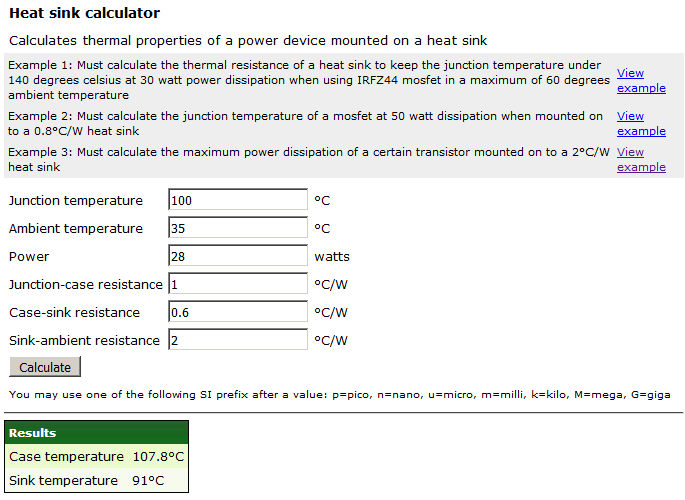

Having to rebuild this circuit as the U2 had blown a hole in itself. This time going to fit a larger heat sink as I suspect summer days shouting the whole panel output killed it, I won’t have been excessive current as it’s protected by a 2amp fuse.

... Note that the full panel output of 20W is dumped into U2, and it has to be adequately heat sinked...
2A*13.6V = 27.2W requires a good size heat sink.
First, here is the Thermal Resistance for a TIP147:
Here is an online Temperature Rise Calculator:
To limit the junction temp to ~100deg C, you require a heatsink with less than 2degC rise per Watt. Just for an example, here is one that has 1.8deg/W with natural (convective) air flow if mounted vertically. How big was your heatsink?
Thanks mike, i fundamentaly misunderstood... mine was a quarter of that size:-(
I do have an spare intel cpu heatsink....
Thanks for the help:) really appreciate it!
Steve

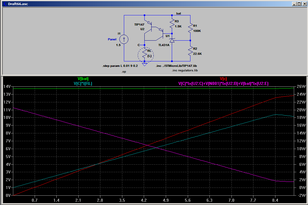

You can add a lamp as shown by RL. However, you want one with a hot resistance of less than ~7Ω if the panel current is 1.5A @ 13.7V. If RL>8Ω, the Darlington saturates, and the regulator stops regulating. If Rl is much less than ~6Ω, then the transistor still does most of the dissipation. There has to be a minimum voltage across the Darlington of a couple of volts.
I simulate the panel as a 1.5A current source and vary RL from 0 to 9Ω (x-axis). V(bat) shows constant voltage of 13.75V while RL <8.2Ω. The light blue trace V(C)*I(RL) is the power dissipated in the lamp in Watts. The violet trace is the power dissipated in the Darlington.
Ideally, about 75% of the power would be dissipated in the lamp, and about 25% in the Darlington (it still needs some heatsinking).
This indicates that you should aim to get a 12V lamp rated at 12 to 15W, like this one, or this other one.
An automotive headlamp is too low a resistance, a parking light is too high a resistance.... Also look at an automotive #93 lamp.
