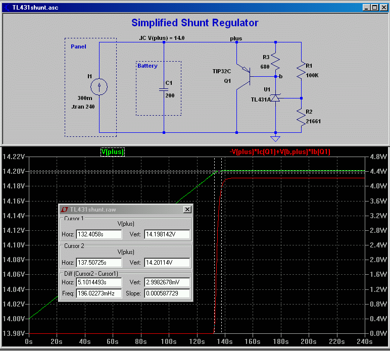

I built this charge controller,
the problem is the leds light drawing 30ma all of the time, which makes the circuit useless. Can it be improved with a better comparator?
Cheers
Steve

One dead obvious 'improvement' though would be to fit the missing resistor between base and emitter of the transistor - this should cure the slight leakage though the LED's, and should have been fitted originally (try a 10K or something, lower if need be).

Like a lot of the circuits posted to the internet, it has a serious design flaw. How do I know? I recently made the same mistake as discussed on this long running thread on another forum. I have used TL431s for all kinds of things involving regulation and voltage comparison.
The circuit is just a shunt regulator, which prevents overcharging the battery after the battery voltage rises to ~14.2V. The LEDs are purely incidental to the operation of the charge regulator. It would clamp the voltage across the battery to the voltage determined by the R1/R2 voltage divider regardless of what is connected between the collector of T1 and ground. You could connect a power resistor, lamp, or nothing at all... If you dissipate the panel power in just T1, then it would have to be on a heatsink.
The glaring error that the author made is that even when the TL431 cathode pin switches to the high state (when the voltage at the Ref pin < 2.495V), the current into the cathode pin is still about 400uA, which is more than enough to partially turn on T1. The solution is to add a 1K resistor from the base of T1 to its emitter (Panel +).
This circuit (with the fix above) will regulate the battery voltage within a few mV. The open loop gain of the comparator inside the TL431 is about 1000.

But 10K is an order of magnitude too high. I recommend 1K, and understand why it needs to be there, and took the time to explain to the TS what is going on.
The TL431 needs some C-ground current for it to work. Data sheet said 0.5mA typ and 0.7mA max. (depends on who made the part and the temperature)
I think we need to think 1mA of current is flowing and that is enough to turn on the transistor.
If R3=1k then I think you need a 1k from B to E of T1. This should shunt 0.7mA around the transistor and keep it off when the batteries are low.

1) He is not happy about 30mA all the time. Fix with a resistor.
2) It is a shunt regulator. It does not directly limit current on its own. It diverts current away form the battery. Indirectly limits current.
Here is a simulation of a simplified TL431 shunt regulator circuit. I simplified the circuit to show only the essential components. The solar panel is simply modeled as a current source. The battery is simply modeled as a huge capacitor. Time scale is arbitrary. The voltage divider R1/R2 is set up to clamp the battery voltage at 14.20V.
The green trace is the battery voltage V(plus). I am showing what happens as the battery charges from 14.00V toward 14.20V. Note that it takes only a 3mV change for the regulator to switch on, which begins happening when V(plus) first reaches 14.198V.
The red trace is the power dissipation in Q1; essentially all of the panel output power goes into Q1 once the battery voltage reaches 14.201V. Note that Q1 would have to be on heat sink...
Also note that R3 has been selected to guarantee that Q1 is off before V(plus) reaches 14.198V. 1K would work, but 680 gives a better margin.
Hope this clarifies how the TL431 shunt regulator is supposed to work...
what is value of r2?
21661Ω. I calculated it to make exactly 14.20V out. 14.20* R2/(R1+R2) = 2.495V. To do this for real, use a trimpot or put two 1% resistors in series to get close to that non-standard value...

and will a small heat sink (clip on) do the job? i like the idea of no leds.
If the panel provides 300mA, the transistor will dissipate ~14.2V*0.3A=4.26W. If you're happy with a 40 degree C rise in temperature of the transistor, then use a heatsink with a thermal resistance rating of better than 6.25 º/W (transistor has 3.125 º/W junction-ambient). Mike's spit method applies if you don't know the heatsink specs.
