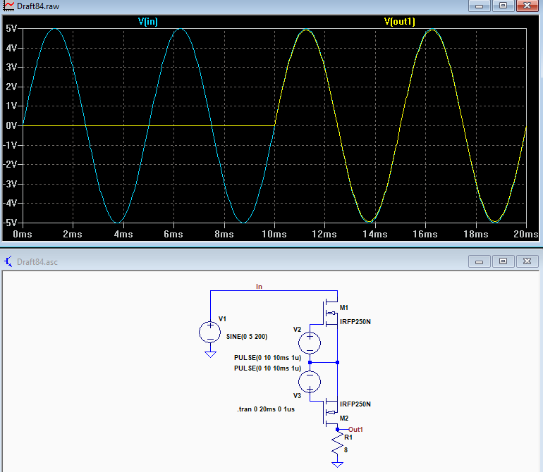

If the MOSFET's are in series, then they are relying on the internal diode across the opposite MOSFET to conduct the signal, so it's like putting two parallel diodes in series with your speaker.
No. Are you not familiar with the fact the MOSFETS conduct equally well in both directions when ON?
So when the MOSFETs are ON in series back-to-back, the back-to-back substrate diodes are bypassed by the low on-resistance of the MOSFETs.
Below is the simulation of that for my understanding of how the opto works:
V2 and V3 are voltages generated by the opto MOSFET LED to each MOSFET gate-source junction.
The output closely follows the input AC when ON.

I can see that your simulation sinewave has distortion at about +3.3V and -3.7V, something like crossover distortion. I cannot see distortion when it is less than about 1% so yours is pretty bad, maybe 1 or 2%. I can hear when distortion is 0.2% or more.

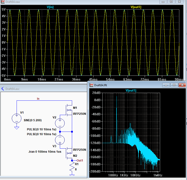

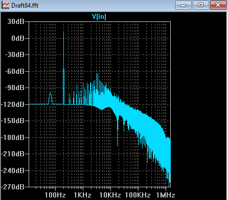

Not sure what you are seeing.
It may be just an artifact of the plot resolution.
The FFT plots below shows little difference between the input and output.
Kian said that the maximum amplifier output is only +/- 6V peak so the power in an 8 ohm speaker is only 2.25W. At such low power then distortion would not be heard even if it is 2%.
